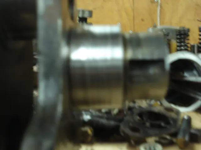

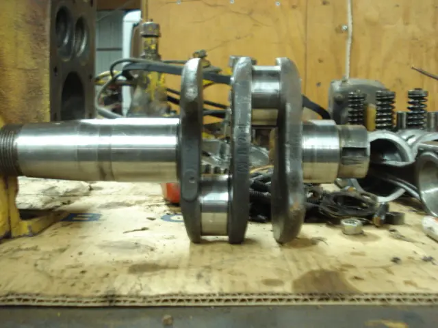

Sorry, I made a mistake,
I measured the most worn postion I could get to get the smallet diminsion
The main on the flywheel side measures 1.8041, the back bearing measures 1.7848
The rod journals are both 1.7352
I notice that in the parts manual, a main bearing that is .030 under is not offered, I wonder if its offered, or should I be looking for a crank shaft?
Thanks, Pat Bayer

You can get the crank welded and reground to standard. You might need to check around for a shop that can/will grind a hollow journal.
When I got my D2 the pony had a spun rod bearing and I found this place Waterhouse Motorsthat would weldup and regrind the hollow journal, they also reground the diesel motor crank as well.

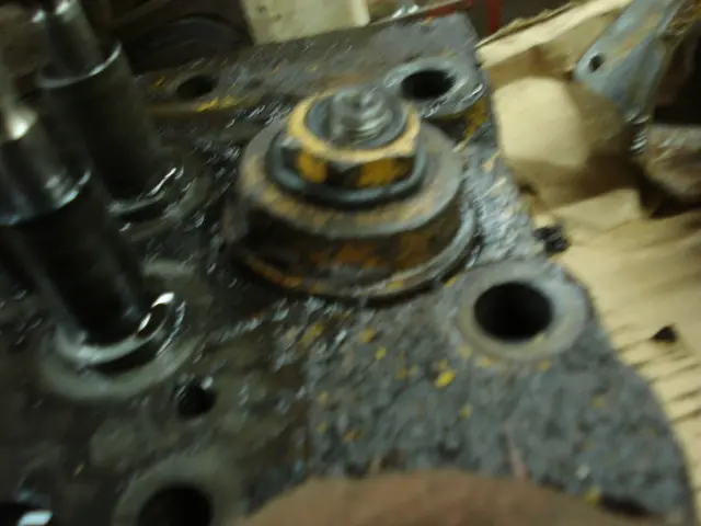

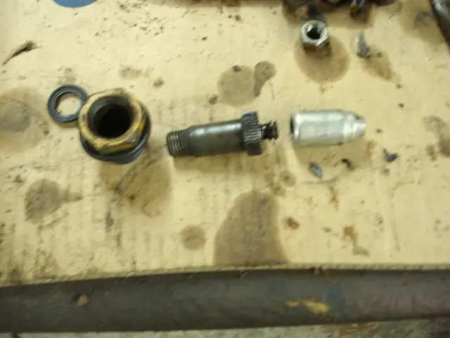

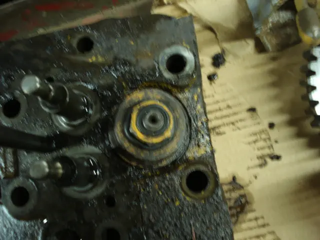

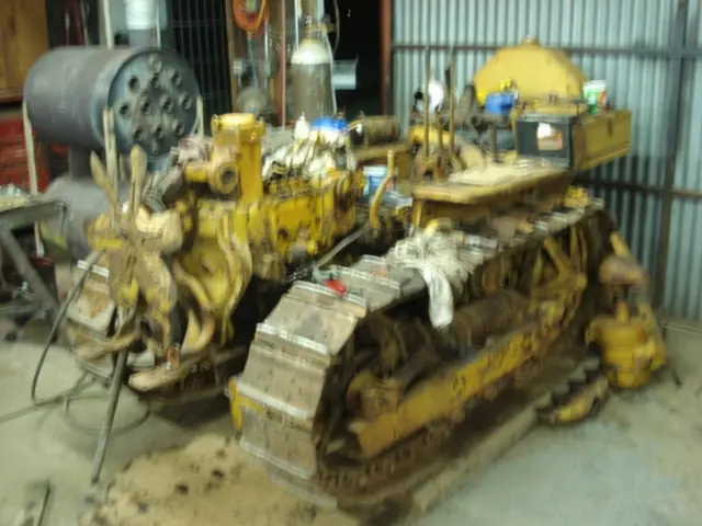

I have the head off of the main engine, I am questioning about pulling the injectors, I pulled the one, and one of the pictures should show how it came apart, wondering if that would be normal, Does that have anything to do with adjustment?

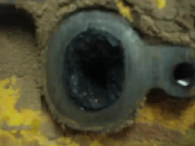

I think that the valve guides are the primary source for the slobbering, the oil was probably running down the exhaust valves and being blown out the exhaust, the oil that was going down the intake was being burn, I have not yet decided if I want to pull the pistons and see the rings, I probably should,
take a look at how the one picture shows how pluged the on exhaust port is in the head
Thanks,
Pat Bayer
Sun, Jan 18, 2009 12:49 PM
bboaz
Send a private message to bboaz
Posts: 298
Reply to R4pat:

ccjersey refered you to my post about repairing the main bearing surfaces of the crank. I turned the undersized bearing surfaces down and made sleeves that press fit with locktite bearing mount for the crankshaft. Then I returned the mains to standard size and used standard bearings. Pony has been running for about a year with no problems. Even in the cold weather we have been having here in Missouri the pony will start (rope start) on the second or third pull.
