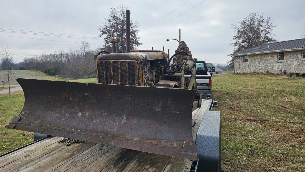

I just aquired this 1941 D2 3J. The hydraulic pump is mounted to the L/H fender......What drives this pump?
You can see the blade control sitting on top of the fender in this photo

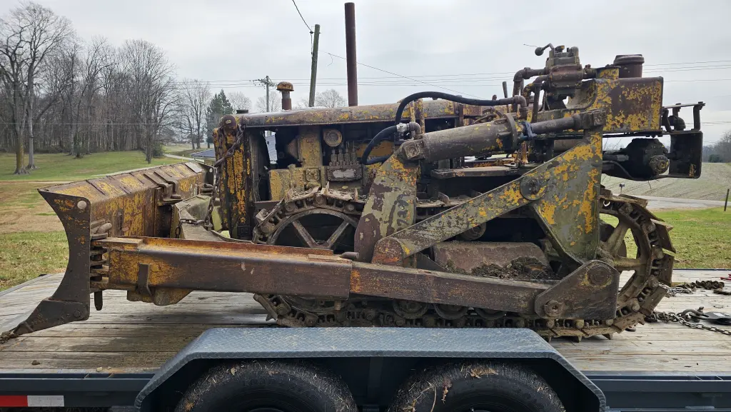

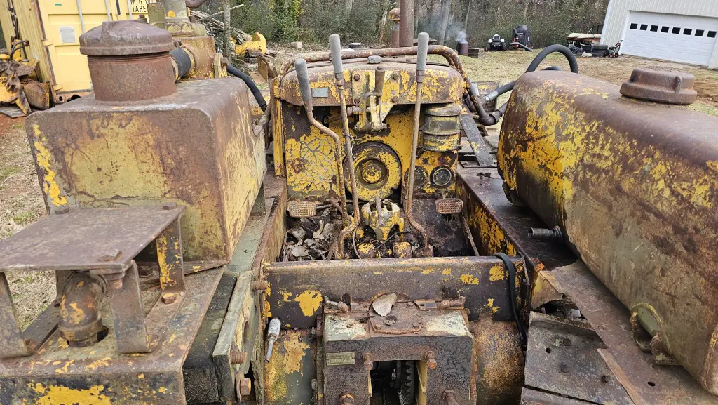

The blade control and hydro pump mounted to the fender here along with hydraulic tank.

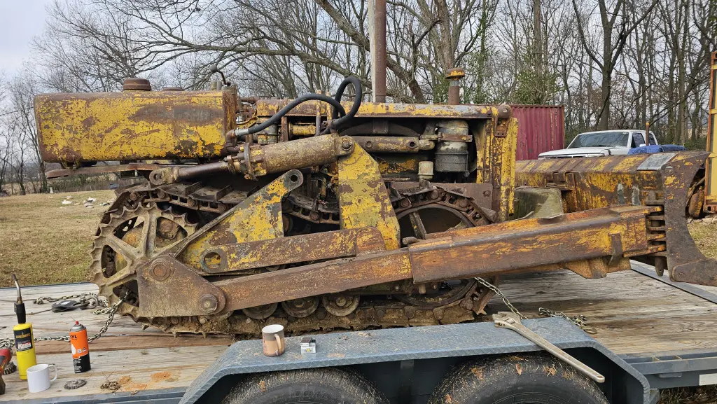

the pump is on the lower left side in the last picture.

PTO unit on the rear? Open hole, since this appears to be a top seat machine (cruiser) the PTO assembly is missing and that would be the key to driving the pump if it is mounted below the left fender. Your photos do not show the pump or rear of the tractor. What a "battle" to work the rope for the starting engine. I do not recall a fuel tank extending that far to the rear nor on the right side. They were bad enough before adding the "attachments". -- good luck --- cts

I cannot tell from the photos, but it almost does look like it ran off of a PTO and drive chain? A person could modify it and have live hydraulics running from the front right where the generator used to be. My former 5J was set up as so, and it was fairly tidy. For a moment, I thought it ran off of an old LePlant Choate pump at the end of the machine, but you have one at seat level?

I sure hope the modifications all fit the operator of that dozer. Is my mind not seeing the picture clearly? The blade control is on the left side? That just boggles my mind..........................run the blade and clutch with the same hand. Went to a lot of trouble to move the fuel tank rather than put the hydraulics on the left. But as long as the operator felt it fit his needs better OK.

Many dozers of this vintage have the pump up front of the radiator with a small drive shaft that runs through the crank hole in the radiator and connected to the front pulley with some kind of drive coupling arrangement. The early J series D2 also had a double grove front pulley one pulley ran the water pump and fan and the other pulley ran the generator. That pulley could be used for a hydraulic pump as well. The only other option would have been a winch that had some kind of hydraulic pump drive option / modification.

So the prior owner used this machine? Or it was just mobile under its own power. I ask because the flat bar stock on the left side (but is only connected on one end on the right side) looks like it locks the blade on that position. Which might not be true, as a lot is not showing in the pictures.
The dozer blade does not care where the hydraulic power comes from, just that there is pressure going to the ram. So no reason to look for a different dozer.
I have a question about what we are seeing in the pictures of the left side. It is below what I take for part of the hydraulic tank on the rear. It looks as if it could an electric motor with a small pump direct coupled to it. Which is not making any sense to me, but whats new with me being confused.
In my experience putting the pump up front as CR was explaining is the best option. If the engine is running, you have hydraulic power. Very desirable for blade operation, not near as important for lifting towed tools. That being the reason so many ag tractors have the rear mounted pumps. Only making power when the clutch is engaged.

He said he used it for skidding logs, not sure exactly how he was doing it as hes abit eccentric now( 76+ yrs old) . That flat bar is part of the blade pivot (lift lower stabilize system it pivots at both ends and has greese zergs)
