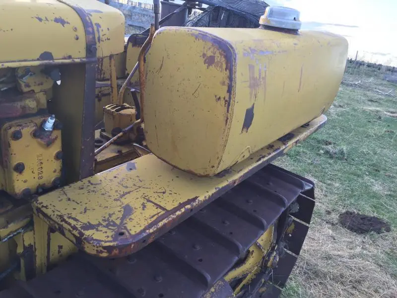

I have located a nice D2 3J Cat.
The tin is in excellent shape and the over all looks are terrific. The cat was used for agricultural use only (for pulling). There is approximately 8850 hours on it. Both the pup and main engines turn over. The engines do not start.
The one issue is that the tracks do not turn.
Does anyone know what may be the problem? I appreciate any insight. Thanks and I look forward to hearing from the experts. I don't think the tracks are seized, could it be an issue with the rear end?

Are you sure the main clutch is working?

Reply to catsilver:
Are the brakes possibly locked on the drums?

Reply to Mike Meyer:
I dragged one up on a trailer with seized brakes once, it took removing the adjustment covers and lots of liberal tapping on the bands to free them up!

Reply to drujinin:
As Dj says, could be seized/ rusted brakes or the tracks are just rusted solid , maybe pulling a little both ways would give a clue. They are easy enough to slide on a hard surface, especially if it is wet. v

Reply to catsilver:
If it's that the tracks are seized with rust, then set them in water (dig a ditch or make a basin that you can sit the track in) - yes, really. The water softens up the rust and works better than any technique other than dismantling. Since you can't get the whole track in the water, run a soaker hose across the top of the tracks so that you soak the tracks that are on the top. Leave it there for a few days, then try it by jerking the tractor to-and-fro. You're trying to initiate any movement and the to-and-fro will rapidly magnify it. Once the tracks are free, then pull it around for a couple of hours to really grind that rust out of there and then if you have to let it sit again, see if you can flush the rust sludge out of the links - might not work but could be worth a try.
If it's not the tracks, then make a note of this and move on : )
Try hooking a chain to the top rear of each chain and pull on the tracks.

Reply to Chuck C:
Chuck C
+1 on Chuck's comment and agree with loosening the brake linkage and thumping the bands as you can.

Reply to Jim Davis:
keep us posted on how things come out. glad you found your way hear. Martin
