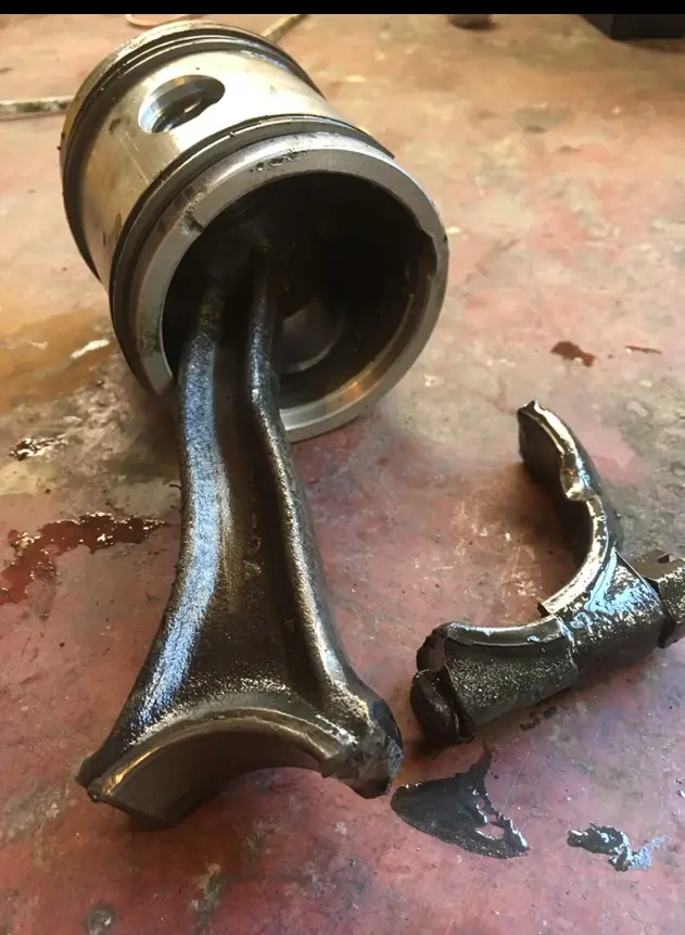

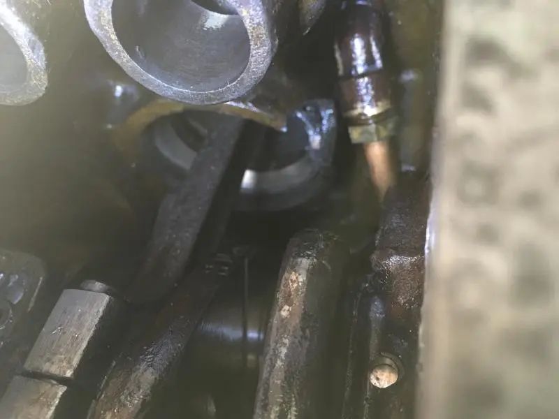

Ok I finally got my pony motor torn down and unfortunately it’s worse than I had hoped but it’s kind of what was expected. There is a 1/2” chunk broke out of one cylinder wall and the other piston connecting rod broke to pieces. can it be bored out and sleeved without being a week spot ? My guess is this isn’t a good idea even if it is possible. I’m guessing my money would be better spent buying a new pony even if it needs work. So if that’s the case who. Has one for
sale ??? I’m in north east Nevada so somewhere close to this part of the world be nice but not necessary

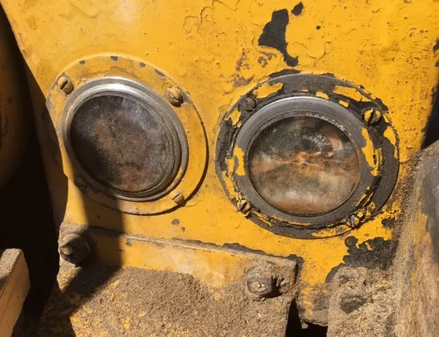

Second question is are these gauges originals ? They don’t work and in bad shape but would like to know if they are worth having restored eventually? [attachment=49719]C2EAB62C-09E9-4CB1-873A-2719820FA16C.jpg[/attachment][attachment=49720]1F645106-A01E-429F-BAE3-8DC784D774AC.jpeg[/attachment][attachment=49720]1F645106-A01E-429F-BAE3-8DC784D774AC.jpeg[/attachment][attachment=49721]C02D0F6C-F31F-450F-B1A6-AADC2CBD5AF6.jpeg[/attachment]

I wouldn't be surprised if you can find one for free, but a hundred should do it

Thanks Neil I’ll post in the wanted section I guess did you get a chance to look at the pic of my gauges ? I’m curious if they are worth the effort of restoring eventually
