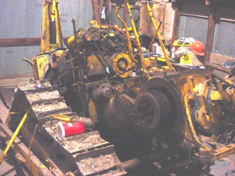

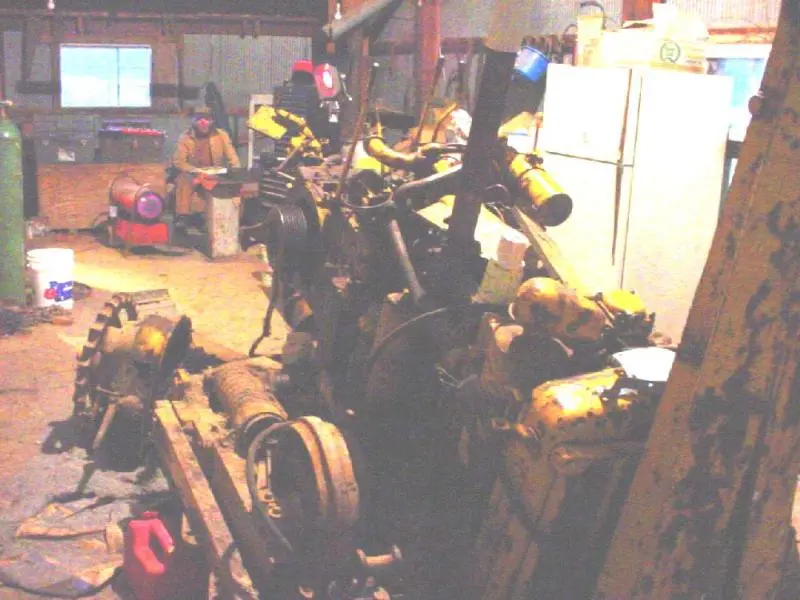

Figured I'd post a picture, not to recent, but not to old either, the old D2 is up and running now, just fine tuning it a little here and there...
