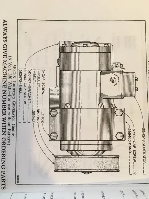

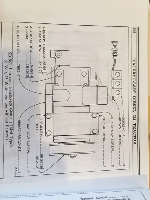

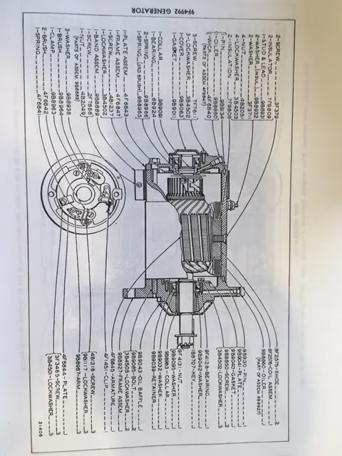

Here are some pictures from Form 6700, the 3J1-5000 parts manual. The battery generator (third picture) is a bit shorter than the battery-less (second picture) and you can see part of the bracket that bolts to the cylinder block behind it. I also posted what looks like a U-series style generator (first picture) with the front plate that permits flange-mounting. The manual doesn't say much about these options but I'm guessing the flange mount probably has a bracket to bolt it to the block, rather than the gear train housing attachment style that the U-series uses. (Note - there are more generator part numbers than just those three but these are representative of the mounting styles)
[attachment=34479]IMG_2477.JPG[/attachment]
[attachment=34480]IMG_2478.JPG[/attachment]
[attachment=34481]IMG_2476.JPG[/attachment]

Hi Joe, I don't suppose you have two sets?
Thomas, there are 6v LED lights with bayonet fittings available - that might give you a bit more lighting punch than filament bulbs, and the light fitting will still look original.
