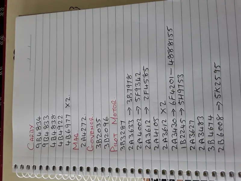

Hi All,
Here is a basic list for gaskets for the pilot motors and there updated part numbers, this includes the seals too. I have not included the baerings or rings.
[attachment=58289]2020-04-20 09.40.03.jpg[/attachment]
Ps can somone pleade turn the photo.
Regards
