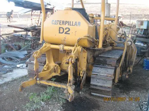

Recently I found Old Magnets wonderful thread on the hitch he made for his D4 (on the archives, don't ask me how I stumbled onto it).
I would love to see what folk have done for the family of machines that include the D2 . I have one picture to get things started, I found this on the Australian ebay site I think.
So any pictures or experiences (or links to same) would be great to see.
Cheers - Foster

That is an interesting three point hitch. I have a D2 and it would be handy to have that arrangement for agricultural purposes. Would be interesting to see photos of what others have. GWH
