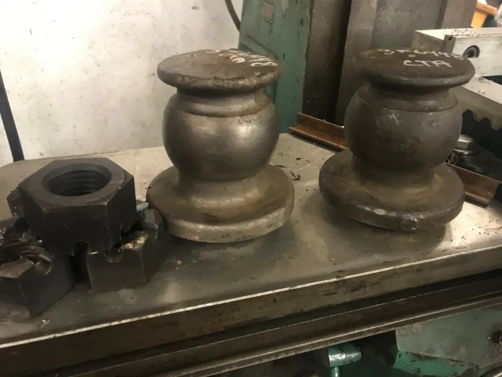

Well I not sure what’s your asking. Trunnions as I know them are as shown In the picture.  That’s where the draft arm or side of the blade push against. But my understanding is the end is radius or female ball sockets so one could not line boring that as you would be only makes straight hole.
Just need to find time to change them on my d6 . Let know if you find a good way to fix the blade arm .
  [attachment=64321]B8417427-EA00-4FEA-95EF-04879D71D9BD.jpeg[/attachment]
