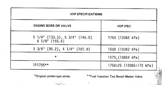

I have the psi but not the lift.
  [attachment=71570]Cat injector psi.jpg[/attachment]
Wed, Mar 22, 2023 9:26 PM
Thank you for that. What type of manual is this located in?
