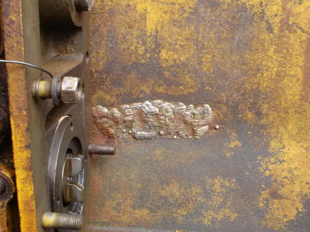

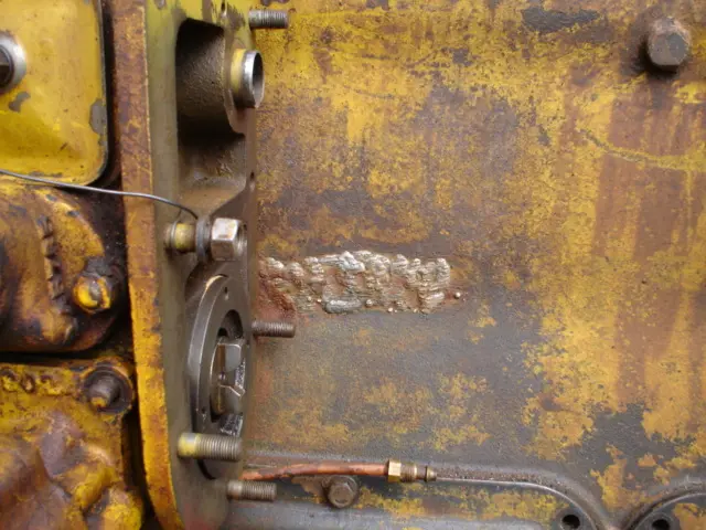

Hey all,
I have what looks like a repaired crack in the block of my D2. This is behind the injection pump. I would have never noticed it except I was cleaning the block up after I removed the ip.
My guess is that the crack was caused by water freezing in the water jacket behind number 2 cylinder. Any other opinions as to the reason for the repair are of course welcome.
I'm not really concerned about it. After all it has been this way for at least thirty years without causing any problems.

You are correct....freeze crack....quite common on the D2's and D4's in that location. Repairs, either welding or epoxy seem to hold up quite well. Not normally a very stressed area of the block.

The weld looks like a high nickel rod was used. It also appears that they used a stitch technique. I'm guessing a stick welder was used.
Like I said in my op it hasn't been a problem for thirty years and I don't see it being a problem for another thirty.
