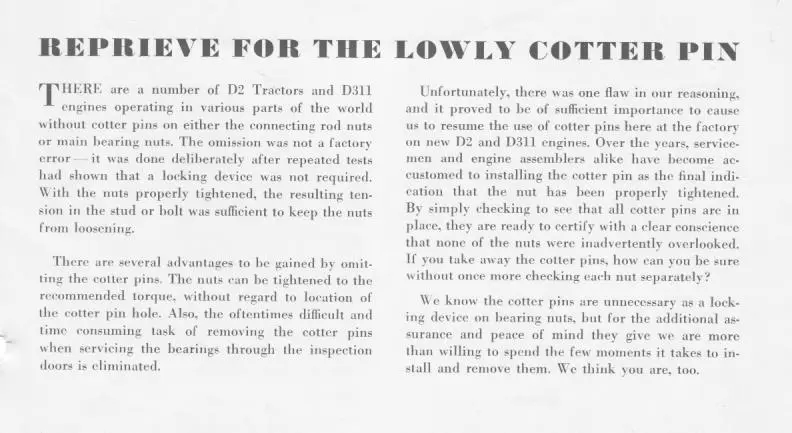

Hi Team,
somewhere I have an article from Cat about these pesky pins.---see scan below.
Back in the forties they experimented with leaving out the pins as it is the stretch of the bolt shank that keeps tension on the nut etc. that keeps the nut from undoing.
Complaints were received from Dealers about the missing pins so they started to refit them until such time as new models of engines were designed and no provision for the pins was used.
From the Service Manual, and as I was taught, it is permissible to advance or slightly undo a correctly torqued nut to align the pin holes, as CCJ said advancing is preferable.
Now we Torque Turn the fasteners and they seem not to come loose if done correctly.
As a by the way, in some applications the actual bolt stretch (length increase) is measured as a guide to correct tension being applied.
