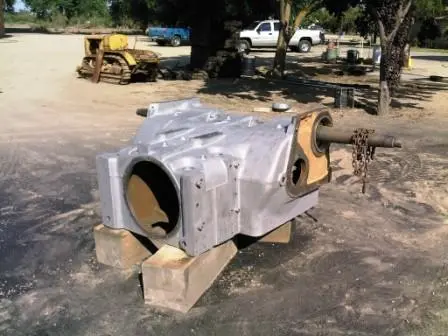

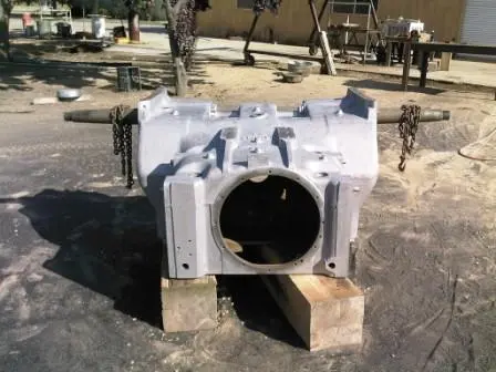

I used copper slag to blast the main case. It worked very well. I think it's worth the extra cost.
