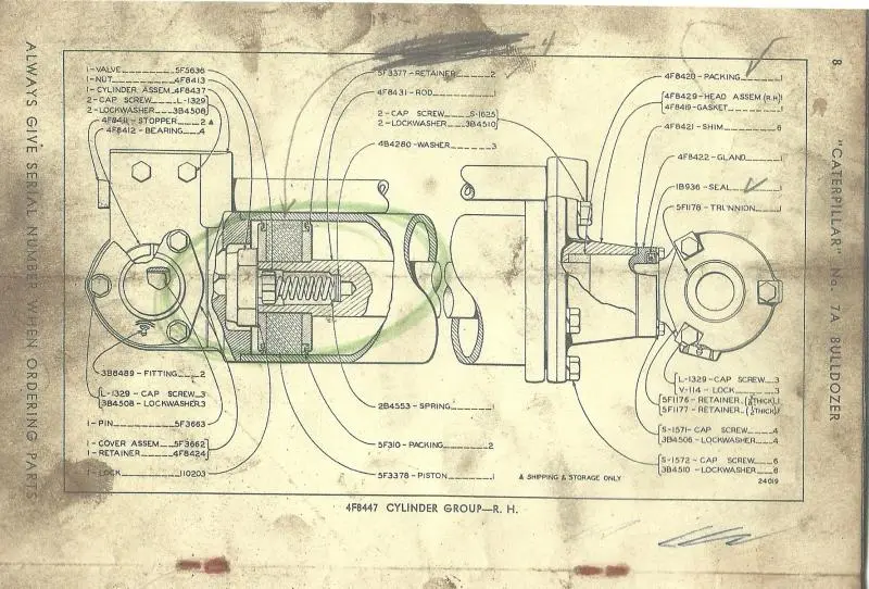

Hi Paul,
the valves you show in the cyl rods are to relieve/bypass oil from one side of the piston to the other when the rod bottoms out in the cyl. It stops a hydralic pressure spike when the ram stops at the end of its travel.
The valves on the top of later Cat blade cylinders are Quick Drop Valves that allow the blade to return to the ground quicker than the the pump can supply oil--faster cycle times for increased production and less power consumed, heat generated etc.
The main relief valves are in the hydraulic tank on these units.
The larger cylinders use more flow less pressure for the same effect as the later small cylinders using less flow more pressure.
In early days the hydraulic components --pumps, lines, fittings, hoses, packings etc. -- were low teck and could not last with high pressures.
