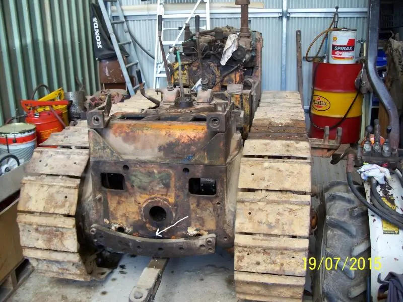

Hi pulpdeth,
When i put the 2T back together this to had a winch, i noticed that Serial Number tag had been moved from it normal place top LHS of the back to the bottom middle a place where the winch dose not cover so you may find it there as per the photo.
Sun, Sep 11, 2016 9:05 PM
pulpdeth
Send a private message to pulpdeth
Posts: 5
Hub size changed part way through 2Txxxx production, the 5T's were all large hub. RD4's (4Gxxxx s/n's) had a different undercarriage that looked like the attached picture. Radiators could be swapped as well as undercarriage. Not very likely that 4G undercarriage would be swapped to later units so that might be a good indicator.
Yes Sir, my undercarriage looks identical to the one in your photo. Thank you kindly for posting the pic.
