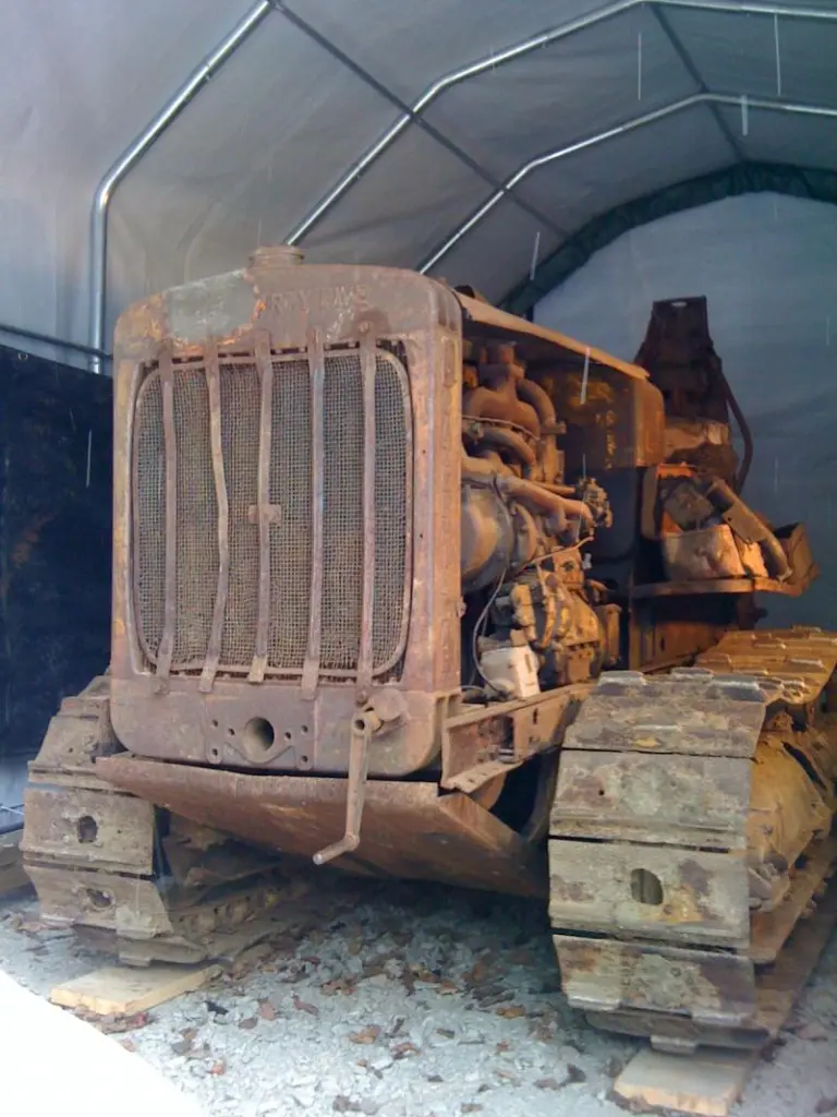

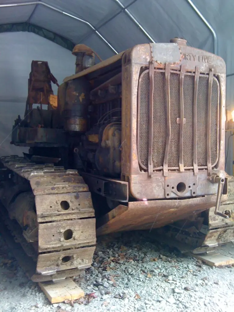

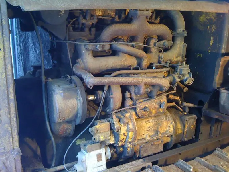

After acquiring my Grandfather's 1934 Diesel thirty five last fall I've finally found time to begin the process of bringing it back to life. The main is stuck and I'm told pony ran ten years ago so will tackle easiest first. As the pony gas tank's interior looks like it's been down on the Titanic, I'm thinking of removing it and inserting pea sized gravel and water then shaking it 'til February !;0) unless a better method is prescribed here. New plugs and wires come next which should tell me if mag will require attention.Any & all advice on my endeavors is greatly appreciated!
