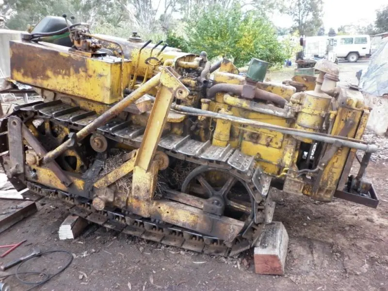

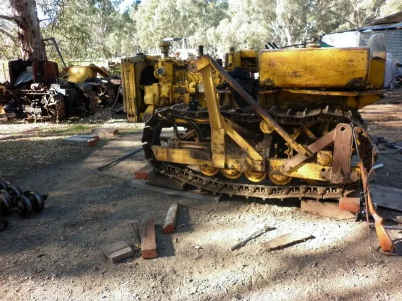

I did my RD4 last year Jim and it was pretty straight forward, just backed the track adjusters right off then sat the Cat on 2 good sized blocks of wood either end so the track sagged down in the middle, hardest part is wriggling the rollers in and out on your own, those things are heavy as you know. I ended up putting a small garage jack in under the track to lift the new roller up to the track frame while I got the bolts in, that made the job a lot easier.

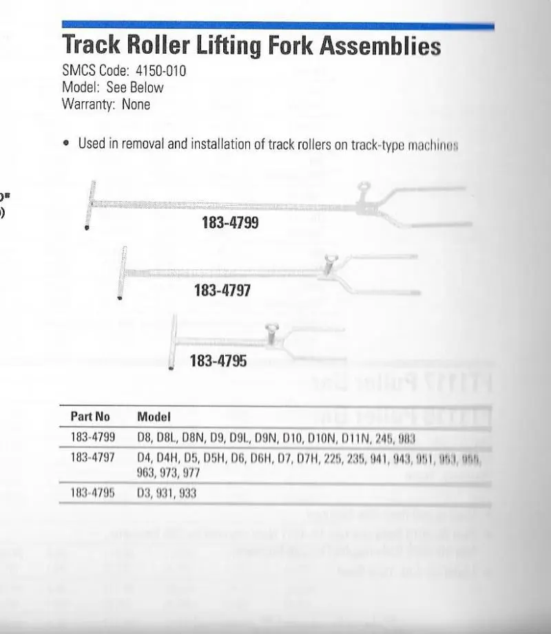

Yes you can. Here you go Jim,
[attachment=52624]track roller lifting forks..jpg[/attachment]
Kelly

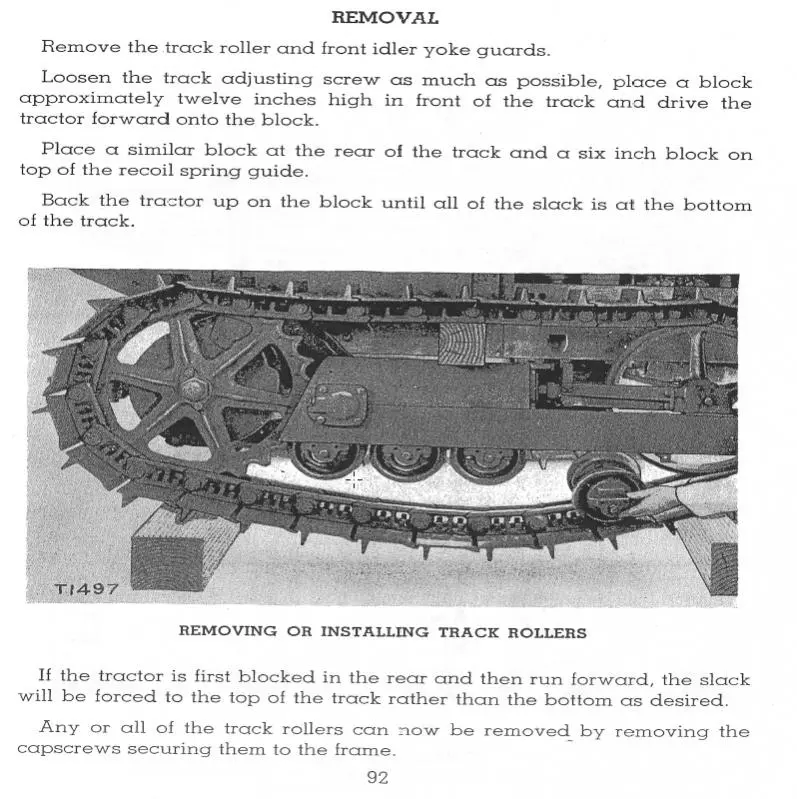

This is from a D2 manual but you can use the same method for the D4;
[attachment=52626]D2 roller replacement.jpg[/attachment]
Jordan

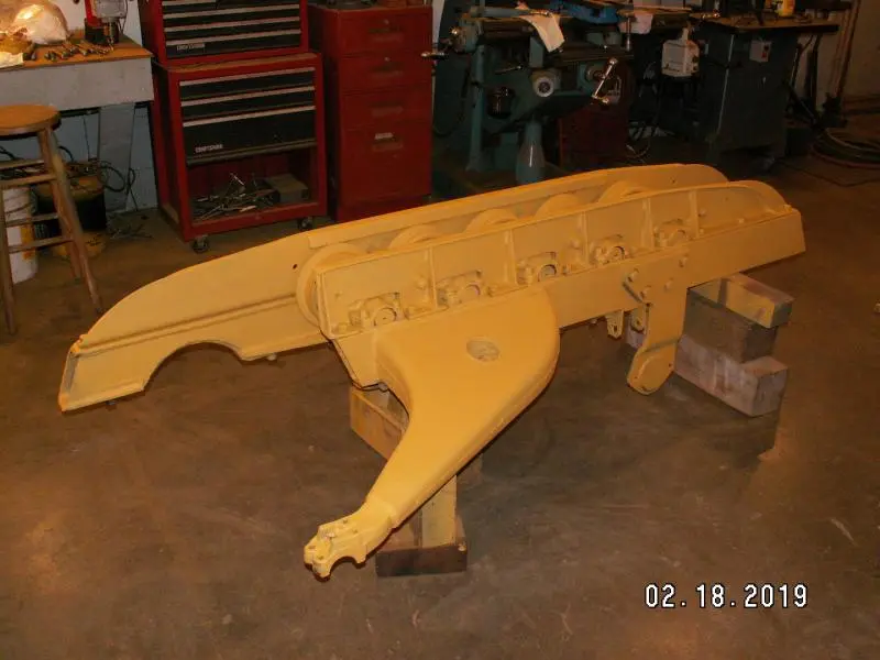

[attachment=52814]D4 022019 001.jpg[/attachment]
Wed, Feb 20, 2019 4:58 AM

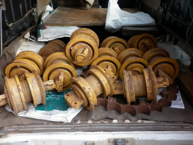

You don't have to - but why not?
I should still have 15 d4 used bottom rollers
Wed, Feb 20, 2019 6:20 AM
