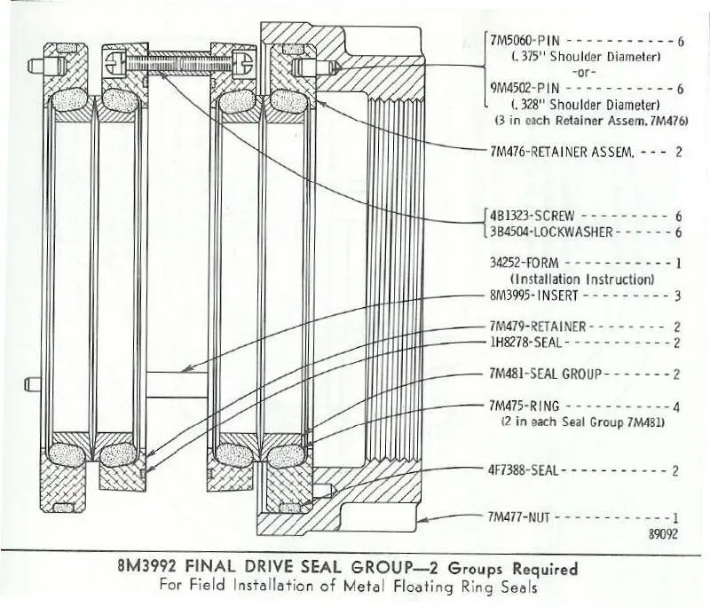

Working on doing my undercarriage swap 9u to D6b. Going well one side done. Problem I have is the sprocket I want to use had bellows type seals with the pressed in anchor pins. Took those out and I am left with 3/8 holes, no threads. New seal ramps are supposed to attach with 1/4 threaded screws. Do I need to helicoil down to 1/4 x28 or did cat supply a threaded bushing to update? Other side had threaded inserts already installed but I did not look that closely as I thought that was maybe normal. Thanks for you help and ideas, Mike

Seems your dealing with something different than the field installation version??

Is the 8m3995 insert what the 4b1323 screws are supposed to thread into? If so I think that is what I am missing. Other sprocket had an insert already installed
Yes, I believe you are correct.

Thanks, I will see if I can locate that or make up three myself. Thanks again

Cat has the 8M3995 insert for $28.67 ea.

Friend that is helping me was able to make three up on his lathe while I fought getting all of the roller changed this afternoon. Tracks back on this evening, hope to finish up the project tomorrow afternoon.
