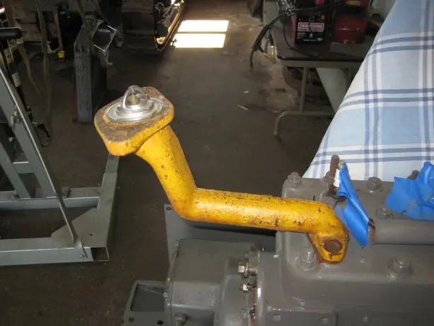

Is this the right way to install the thermostat in the cat ten. Pictured is the upper radiator pipe with the thermostat.

If that pipe is the one going to the radiator as it looks like it is then in upside down.The spring part and senser always goes toward the engine block.When it opens then the coolant can go to the radiator for cooling.

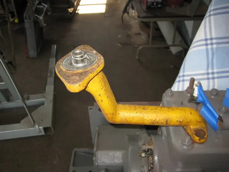

Thanks SJ, so it should like this...

i meant like this...

Like this....

Matt the second pic is how mine was when I took apart😊

Yes Matt, the 2nd. picture is right way now.

The gas-operated piston (that is visible on the top of the first pic) is the device that needs to be in the heated water to make the thermostat open.
Thus, it has to be on the bottom, where the hot water is coming from the engine, for the thermostat to work as designed.
