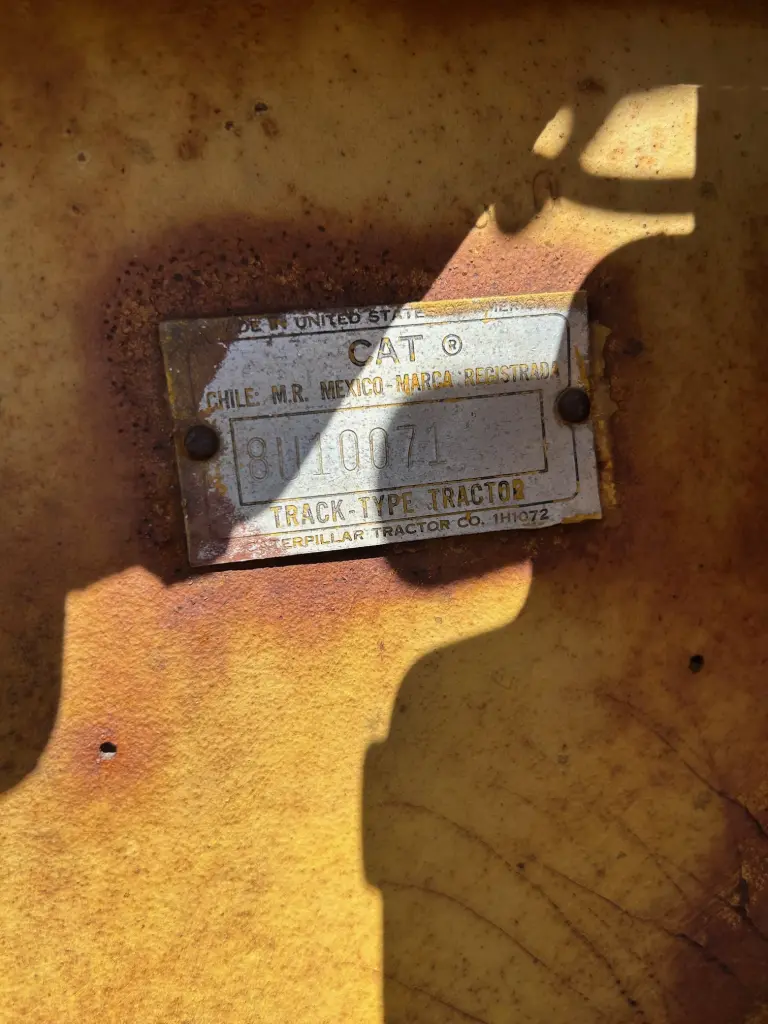

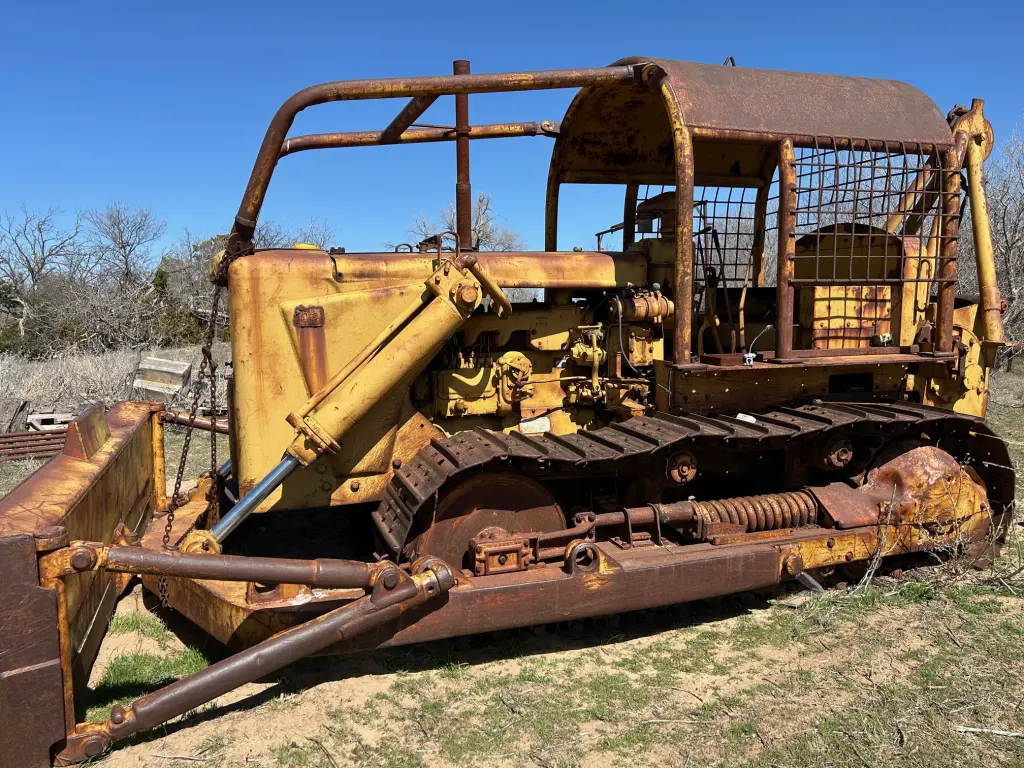

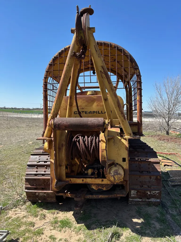

Hello all ! Just signed up. I have purchased a D6 8U10071 and not sure exact year ? maybe you guys can tell me ? Anyway spent about 6hrs split between 2 days and got her running. Everything seems to be in good order except the blade will lift the machine completely off the ground but won't lift above the dirt. Any ideas were to start ? Thanks !
Sat, Mar 15, 2025 2:05 AM

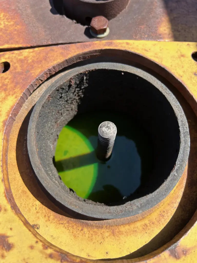

could be the rams bypassing internally. if they feel hot that may be the issue.
these do have a float position for the hydraulic control. are you sure your working the lever the right way and not going into float.

also before anything else check the oil level in the hydrualic unit it should be at visible the bottom of the filler neck
Sun, Mar 16, 2025 12:14 AM
