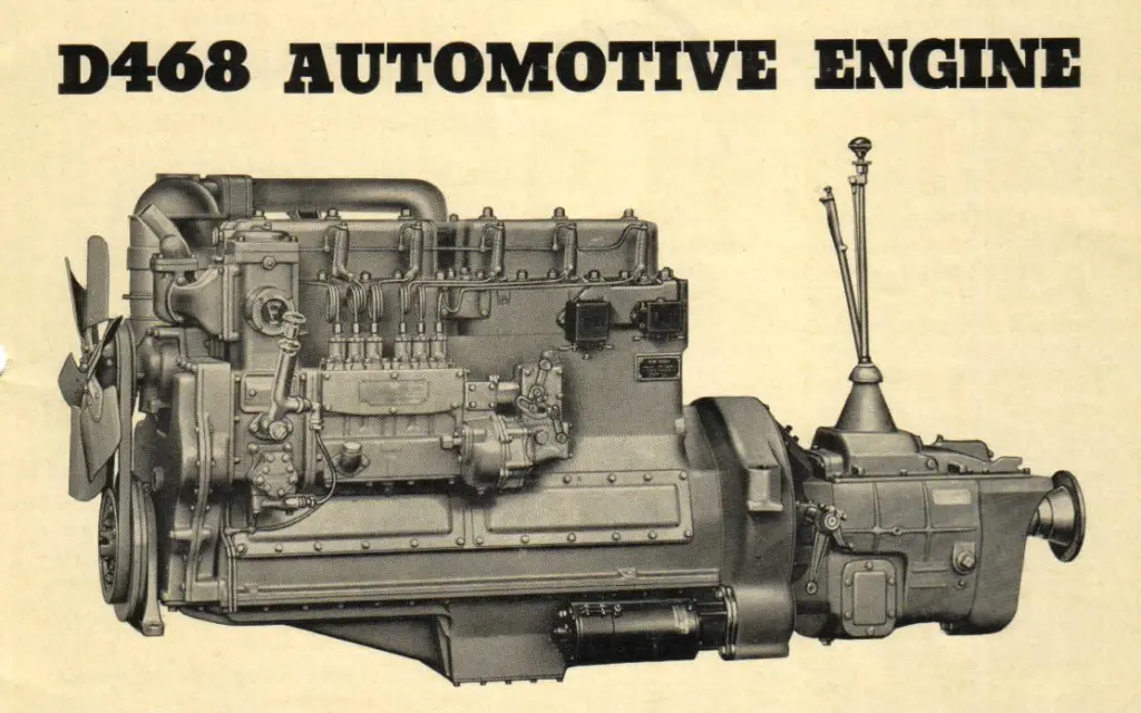

Are you referring to the D468 automotive engine? Series 1N3001-up.
Edit
After checking my rack setting chart manual I see a D312 Automotive s/n 1N6001-up, based on a D4400
Don't have any info on the D312 and have never seen one.
Looked up the s/n's, started at 1N6001 and ended at 1N6020 so not likely there are any around.
Ā [attachment=69653]catd468gi5.jpg[/attachment]

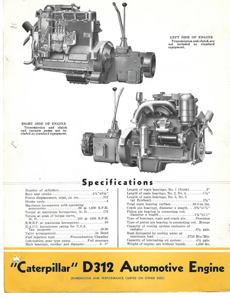

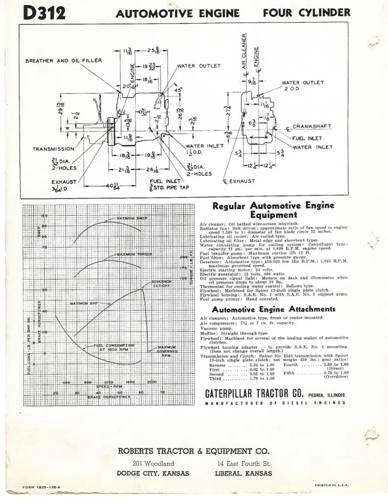

The spec sheet.
[attachment=69673]D312-1.jpg[/attachment][attachment=69674]D312-2.jpg[/attachment]

Thanks for posting that spec sheet! I have an extra D4400 I'm thinking of converting into a D312 basically to install in my one 1940s Mack EF. I'd like to keep as close what they were as possible. I believe like govenor was basically that of the D468/D4600 used in the early DW10s so that may be able to be found. The manifolds I'm sure I'll need to fabricate. I believe from my parts book though the intake maybe similar to that of the D4400 marine engines.

If you don't have it already, there are a couple D312 automotive engine parts catalogs on ebay, I could try to cross part numbers to see what applications the parts had, although for some of the low production units and parts, the NPR does not always list.
