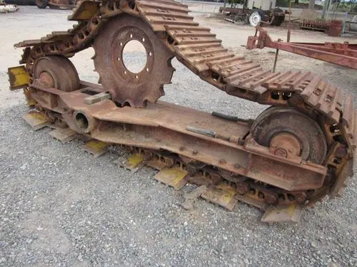

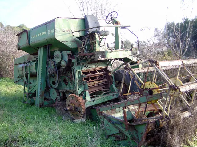

MATE these are used on rice headers or combines as you blokes in yanky land call them
they also make a similar thing for sugar cane harvesters although they use D4 tracks as a cane harvester is a lot heavier
the first 2 are a rice header and tracks for a rice header the rest are for a cane harvester

It would be interesting to see if there is a Part Number on those sprockets to see if there is another Crawler out there in the World that used the same pitch on their Rails.
90 links and 8 rollers per side will give you enough for all your D2's!

Thanks for the replies, fellas. Paul, that first picture you posted of the combine has the exact same sprocket and hub assembly that I found on these here. Thanks for all the info and pics.

I believe they were used on the J D 55 & 95 harvesters in the rice when it was too muddy for rubber, it looks like someone customized the ones you have, all the ones out her that I have seen have 4 rollers, 2 idlers & 31 links per side. Lots of good stuff with usually very little wear.
