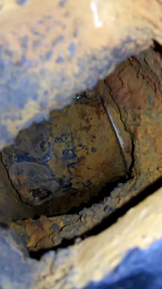

My belief is that the part of the head that screws into the chamber is rusty / rotten and is leaking water in, so I might have to take the head to be repaired if it checks out. Thankfully there's a guy specialized in testing / repairing engine heads just down the street from the CAT dealership.
This is what I'm talking about, this is looking from the head water outlet (to the radiator):
[attachment=43913]20668328_894095777407603_860629874_n.jpg[/attachment]
Apologies Jorge, your tractor will have the splined interior as bcwayne correctly stated. You can see a picture of it on eBay at http://www.ebay.com/itm/5F8353-Pre-combustion-Chamber-Wrench-tool-for-Caterpillar-spline-chambers-/182362570125?hash=item2a75a7fd8d:g:HgIAAOSwal5YNFjt You're very unlikely to be able to remove it with a pipe wrench.
The entire chamber screws in with threads at the bottom end adjacent to the cylinder side of the head. The top side, where you removed the injector from, just protrudes through the hole with an o-ring to seal it. Once you have them out, you'll see the seat inside that the chamber screws up against, sealed with a copper washer. That seat needs to be in good shape, so if it's pitted, you might need to have it machined down and use a couple of copper washers so the chamber is correctly located in relation to the head.

Get the splined removal tool, new chambers, copper/soft steel sealing washers and o-rings AND some copper antiseize compound. Forget the glowplugs if the chambers to fit them are not easy/cheap to get. Use the standard chambers and keep a can of starting fluid/ether for the times when it needs a little help.
If the chambers do not break loose and come out easy, stop and screw back in, back out until it binds, back in, back out etc. This may prevent removing threads from the head. The chamber threads don't matter, you are replacing them with new anyway, but saving the threads in the head is well worth taking some time removing the old chambers instead of just removing them with brute force. If the threads in the head are damaged beyond cleaning up with a tap, they could be repaired with an insert or perhaps drilled and tapped to take the D315 chamber as mentioned earlier.
In any case, an application of antiseize to the threads of the new chambers is a very good idea. I like the copper type antiseize because the washers are copper or sometimes copper plated soft steel.
The picture attached is from a later (early 1960's) version of your D311 engine, but should illustrate the assembly adequately for your purposes of removal and replacement. Do not use the part numbers shown without checking they are correct for your late 1950's engine.
Edit......looking at your photo, the chambers may be fine, just need new seals and perhaps cleaning up the seats in the head where the seals touch. There may be a kit with a stack of several different thickness copper washers/seals to use so the glowplugs do not stop where they will interfere with the injector fuel lines. If the glowplug hole stops in the wrong area, remove and replace copper seal with a thicker or thinner version to move the glowplug hole.
With the head removed, you might help chamber removal by brushing away the carbon and spraying some type of penetrating oil into the threads on the tip of the chamber that shows in the top of each cylinder.
