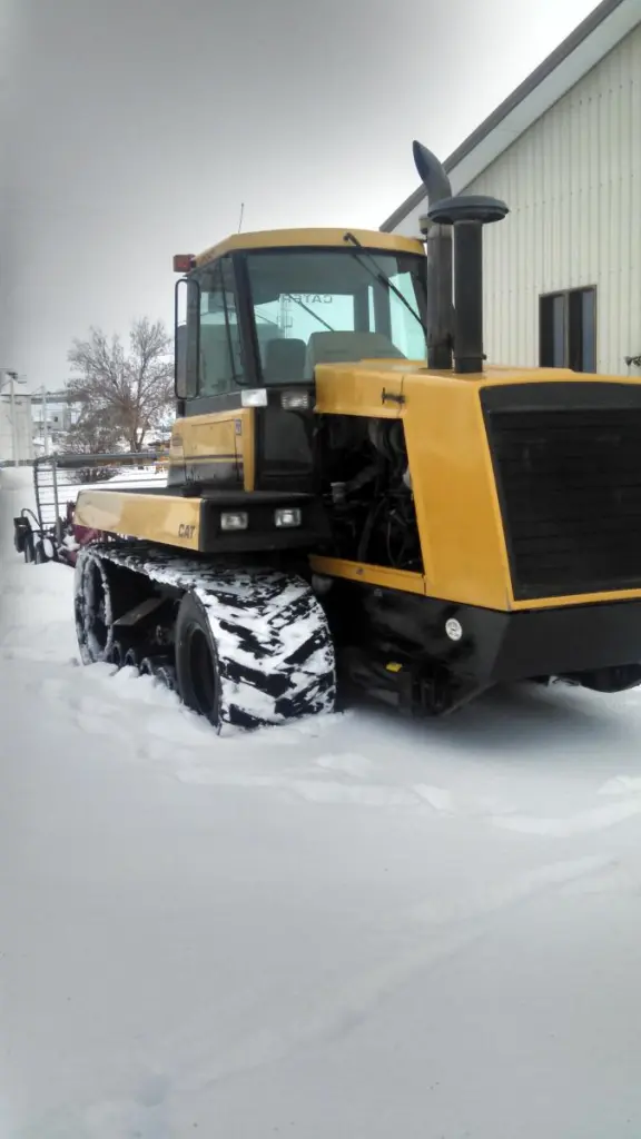

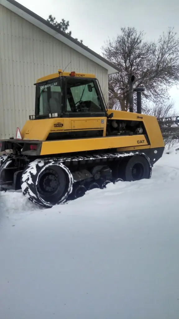

Decided to go ahead with the purchase.With all the great replies and a couple of calls to Clayton .Gave me enough information to make a sound decision .Checked out all the concerns with the crawler. Climbed up in it started right up cold . Warmed it up took it for a spin . I went through all the gears .Spun some donuts and checked the brakes . Performed well so we[attachment=40121]IMG_20170207_124234_632.jpg[/attachment][attachment=40122]IMG_20170207_124251_319.jpg[/attachment][attachment=40121]IMG_20170207_124234_632.jpg[/attachment][attachment=40122]IMG_20170207_124251_319.jpg[/attachment] added it to the tool shed. Thanks so much guys BIG HELP !

Sorry guys. Messed up adding pictures. Hope its not to scrambled to understand . Don't know what happened

thats really good by the looks of it and neat and tidy for its age I hope you have a great trouble free run out of it
