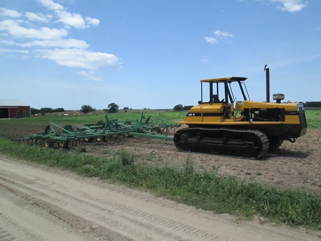

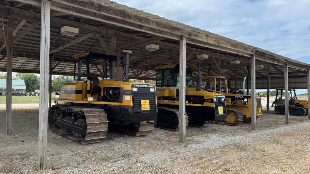

Good Morning ! I just join here try to figure how to get in on your coversation on Cat AG6 , looks like its been a while back on this discussion , But we calculate around 100 AG6 built , we have s/n 5X01355 here which Cat told us its the last one Built , on pictures its the one in the shed , we are keeping that one for our collection, other pic is s/n 5X01338 we farmed with a little but have sold it since, we have pics of 20 differnt s/n AG6 , we either seen , or seen advertised,

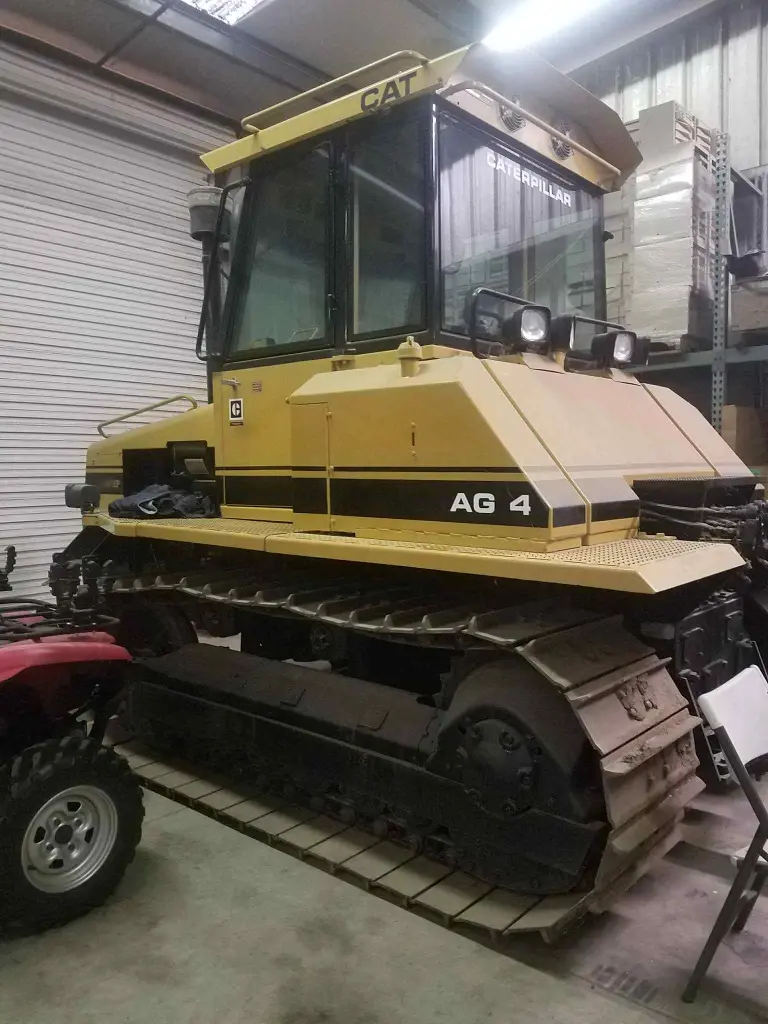

There is an unused AG4 in Stockton, CA that a friend of a friend has, even more unique than one of the 6's.

Here is a picture of a AG4 that we have in our collection , i would be intrested in seeing pictures of the one you talked about .

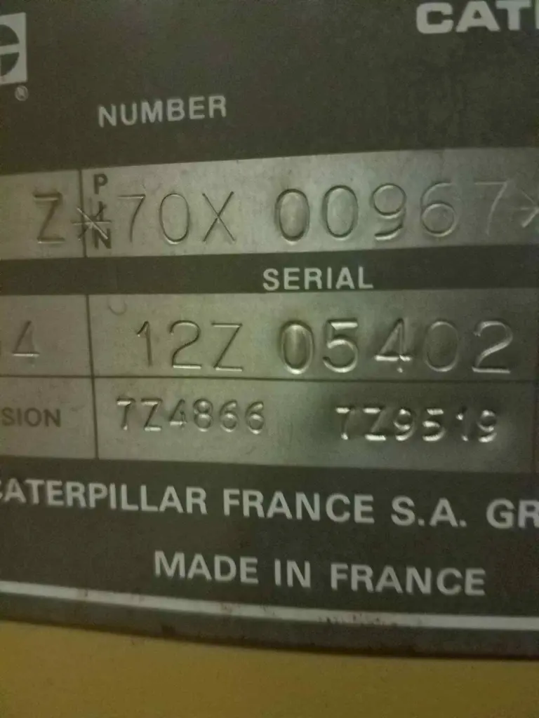

Here you go. As far as I know, they keep it locked up and it never sees daylight. Our shutterbug CTS might look for the AG6 I had mentioned in Colusa, CA. JM
