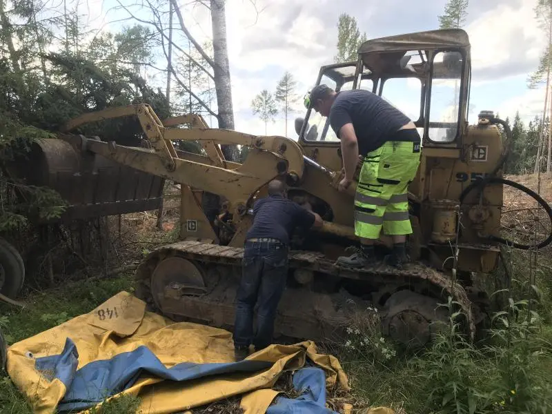

Hello.
Today I bought a Caterpillar 955, but have No info about it at all.. I dont even know the year of it..
I found a serial number: 12A2495
Can anyone Help me find the year of This one and Maby Weight and other spec?

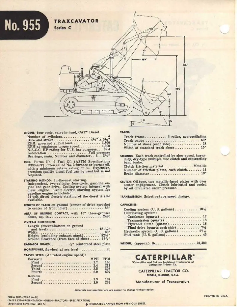

Coincides with the change from the HT4 to the 955 12A series in 1955.

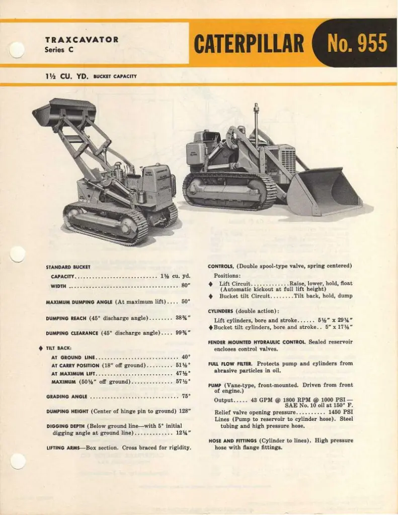

Spec sheet from mid 1956.
Sat, Jul 14, 2018 10:21 AM
Muttson
Send a private message to Muttson
Posts: 12
Reply to josh:
Thank you very much!
Realy good help!
Sat, Jul 14, 2018 1:46 PM
