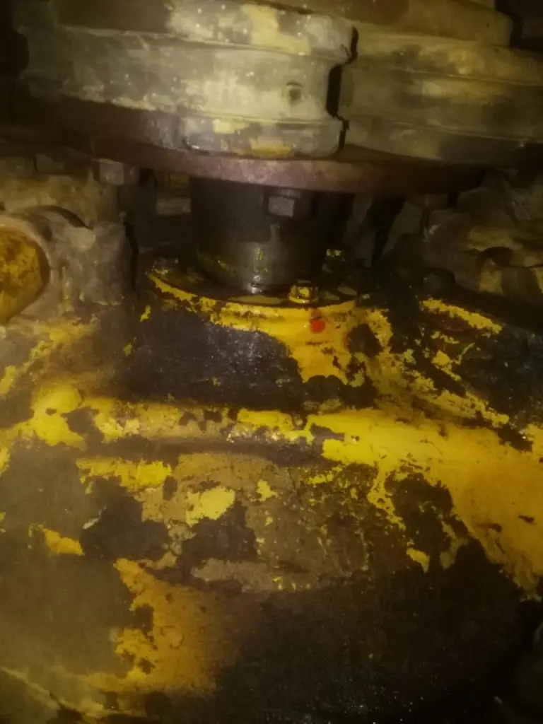

Hello everyone. My 951c crawler loader gets a lot of oil from the converter. I wanted to know how to drive it without dismantling half a car. Loses where the flywheel is engaged. I enclose photo. Thank you all.

Removing the flex coupling flange and biscuits will give you access to remove and replace the torque converter seal.
With the couplings off and flange removed you can usually get some form of pry bar in there to remove the seal.
Putting a new one in is best done with a puller of sorts. There is not much room there to work. I use an old bearing shell, a flat bar and two 3/8 bolts of the correct length to pull the seal into place.

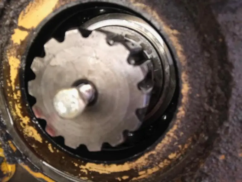

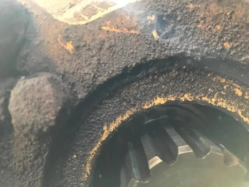

Hello.
I removed the support.
The oil comes out of the central hole of the toothed pinion. I put a bolt to keep out the oil drops.I don't have to close that hole right?
The seal to put and this 1d4326?
I attach photo.
thank you[attachment=53817]IMG-20190511-WA0003.jpg[/attachment][attachment=53818]IMG-20190511-WA0000.jpg[/attachment][attachment=53819]IMG-20190511-WA0001.jpg[/attachment]

1D4326 is the correct seal number. Also a National Seal #455002 or a CR/SKF #25641.
There is a plug # 5S3585 in the flange that contains the oil when assembled. Allows for spline lubrication.
Also would be a good time to check coupling alignment between engine and torque converter. It's fairly common for things to get out of alignment and you wind up eating the rubber biscuits.
As Old Magnet says, do not block that hole.
1D2436 is correct.
Check the shaft for play to make sure you don't have a bearing on its way out.
Remove two of the four bolts around the seal housing, and make up some sort of puller, and use those holes to pull the seal in. Sorry, I don't have a photo of my set up, but it is just an old bearing cage with a flat bar behind it with two bolts to pull the seal in.

Yes you need the 5S3585 plug otherwise it will leak oil again. If the plug wasn't there that's probably the source of your leak.
