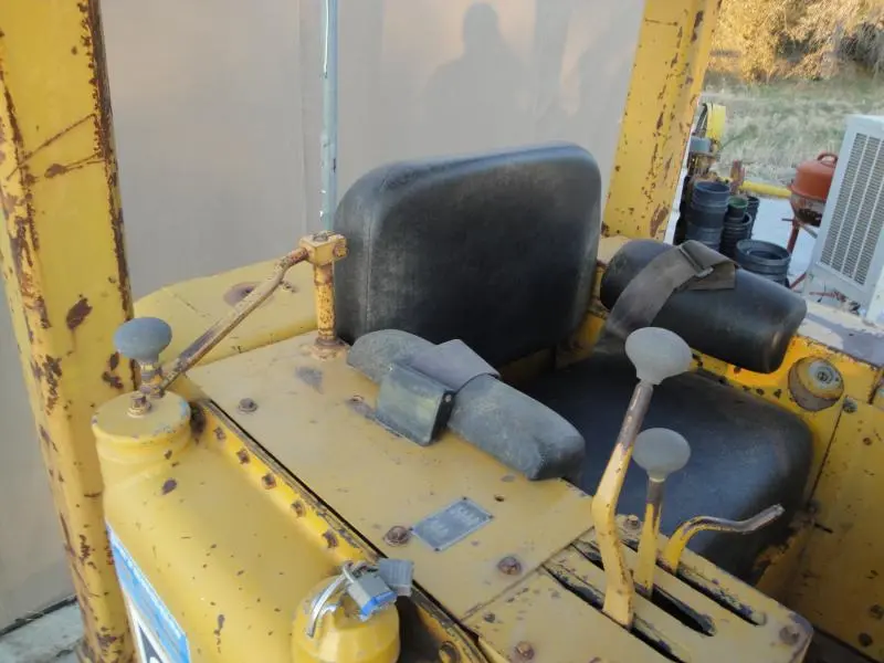

I use 10-40W oil everywhere on my machine, engine and hydraulics. The ripper controler would be next to the rear of the RH arm rest, it's not part of the 3 levers for the 4in1 control. I'll try to remember to take a picture of it tonight to post on here.

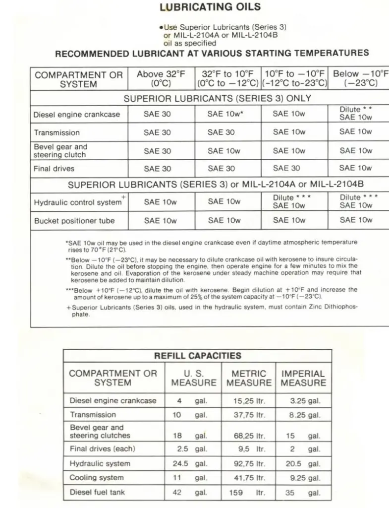

Cat changed the oil specs for all the powershift machines, the old oil spec of series 3 30W no longer applies,it has changed to TDTO 30W, (Transmission Drive Train Oil 30 weight) the page from original manual below states that all the oils except the hydraulics were SAE series 3 30W,the new spec oil is to increase clutch life.

Always a straight 30w transmission oil in any powershift transmission, do NOT use multigrade, the needle rollers bearings break the polymers down to the lower viscosity and causes excessive bearing wear. I've seen it, and the oil rep who reomended the 10w/40 oil would not help in the early hour failure!

Here is the ripper control on my 1975 951C, I've always seen the control in the same place on the C models.[attachment=11094]DSC02556.jpg[/attachment]
