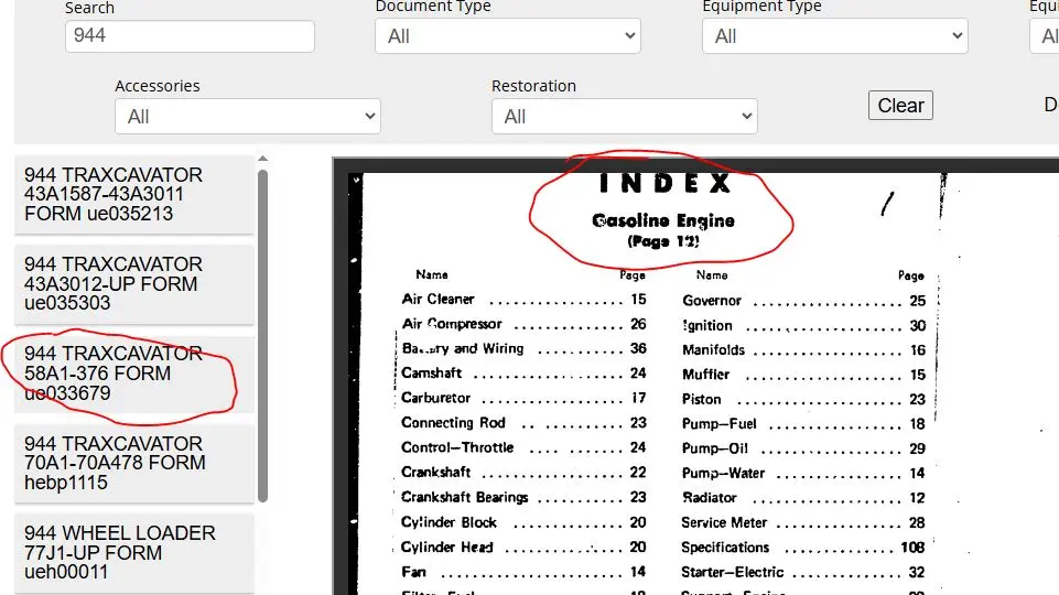

Hello Folks. I recently picked up a Cat 944A with the Continental gasoline engine in it. I heed to pull the head off it, does anyone know which flat head 6 Continental engine it is?
Thanks, Bill.

 58a1-376 gasoline flat head enine
[attachment=76793]Capture.JPG[/attachment]

Reply to bruce oz:
Yes, big flat head 6 cylinder. Manifolds on the machines left side.

Reply to bruce oz:

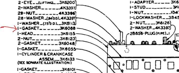

Correct, that is Caterpillars information on the engine made by Continental. I'm trying to find out what model Continental engine Cat used so I can get a head gasket for it. My local Cat dealer basically laughed hysterically when I told him what I needed.

head gasket - 3K6088 GASKET-HEAD Caterpillar parts
 [attachment=76794]Capture.JPG[/attachment]
