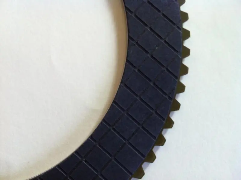

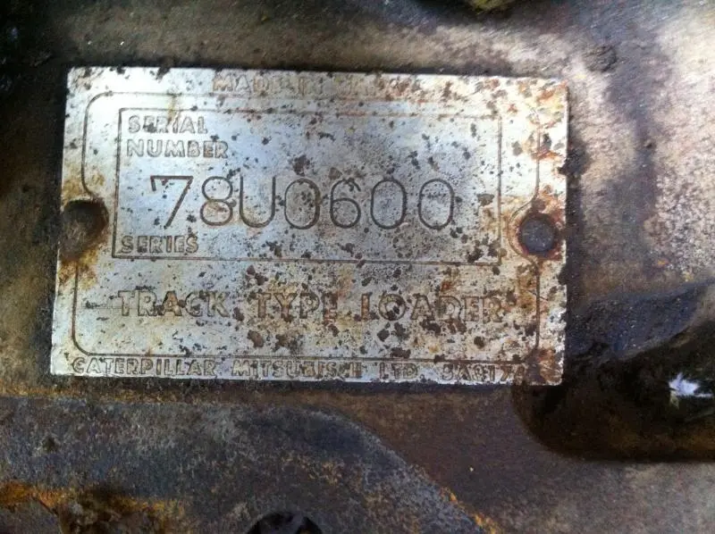

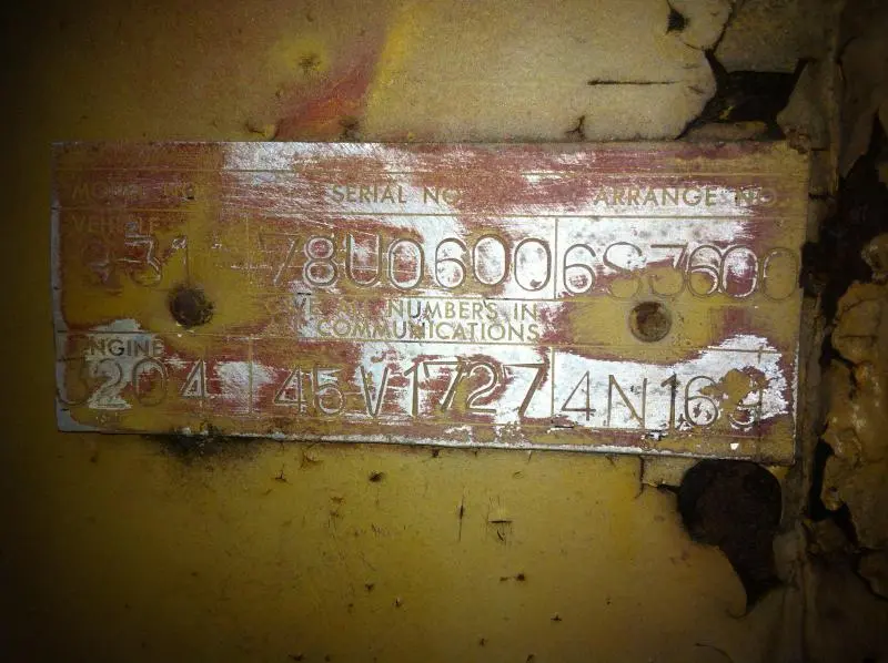

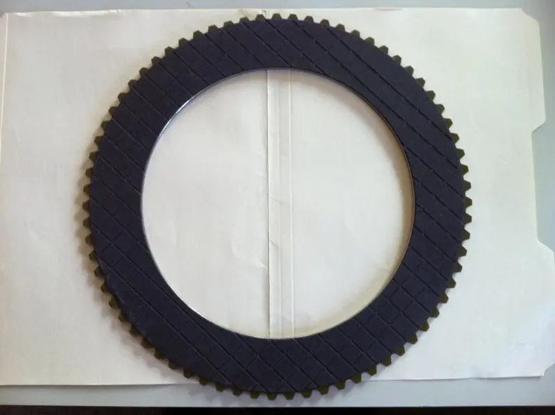

[attachment=19117]IMG_2450.jpg[/attachment][attachment=19120]IMG_2459.jpg[/attachment][attachment=19116]IMG_2448.jpg[/attachment][attachment=19118]IMG_2457.jpg[/attachment][attachment=19119]IMG_2458.jpg[/attachment]I have a Cat 931 s/n 78U0600 that is in need of steering clutches. First off I am not sure of the exact year of the machine - any help? Second, I was wondering if anyone has any input on the Steel-based friction disc vs. the Std. Fiber discs offered by General Machine. What is the thickness of a Std. fiber disc when new? Any info you can provide will be greatly appreciated.

I show production year as 1974.

I seem to recall that the early 931's were dry steer clutch and brakes and a Field Conversion could be done to part fill the steer compartments with oil --likely announced in a Service Magazine, later than I have.
The lined discs were also fully made from the disc material--ie--no steel in the centre like the ones pictured.
I think the ones pictured are for wet rear ends. I stand to be corrected.

I believe the p/n is 8E4075 (earlier p/n's:6Y4912 or 6S3183). The discs pictured are from General Gear and Machine in Boise, ID. (steeringclutch.com) They are supposed to be a direct replacement for the fiber discs and the steel core is to prevent broken off teeth. Thanks for your Help!

All three part numbers are Fully Organic 303.5mm x 213mm x 4.9mm (71 outside tooth)
Looking at the D3 parts manual these discs would be used with 2H6936 steel plates 289mm x 194mm x 2.3mm (8 inside lugs).
These are all dry clutch numbers.
Wet clutch is a completely different set of numbers.
