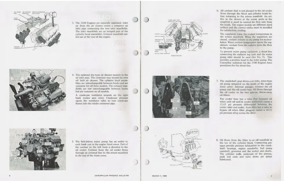

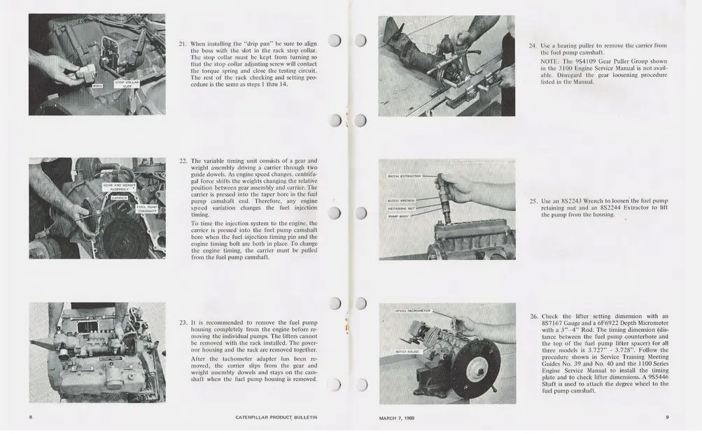

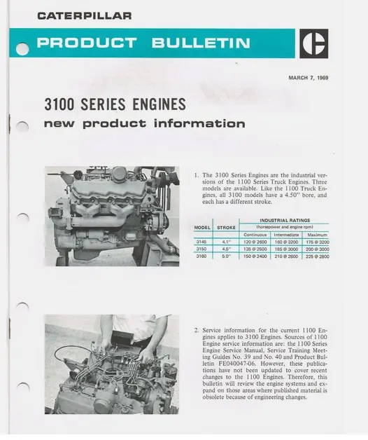

Here's the Product Bulletin on the 3100 series...
 [attachment=75023]3160 Engine #1.jpg[/attachment]
 [attachment=75024]3160 Engine #2.jpg[/attachment]
 [attachment=75025]3160 Engine #3.jpg[/attachment]
Thank you old magnet.
