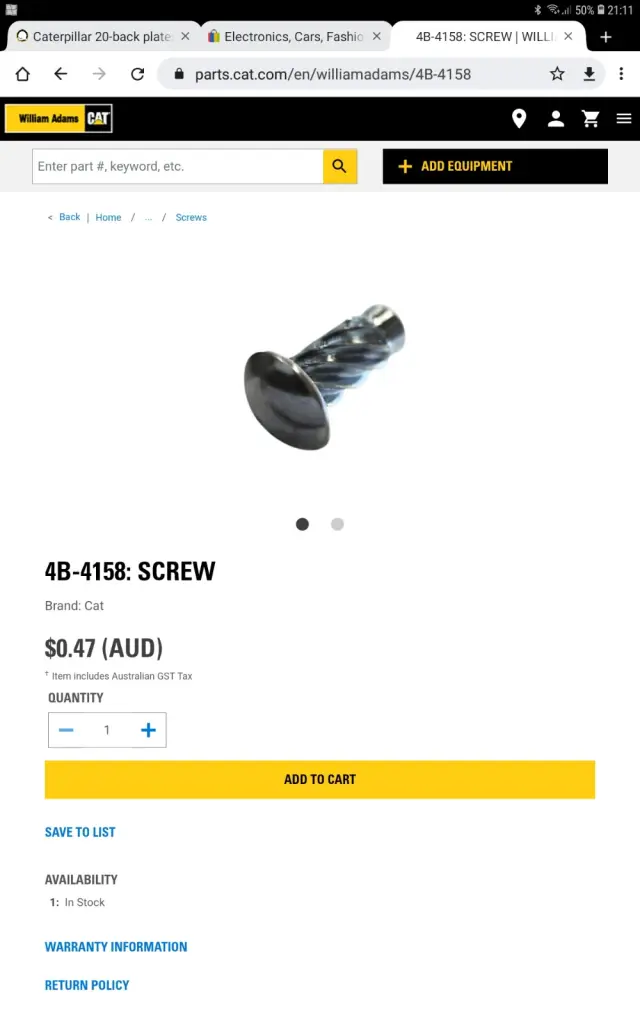

Yep still avaliable.
 [attachment=67263]Screenshot_20220404-211134_Chrome.jpg[/attachment]
regards
Mon, Apr 4, 2022 6:13 PM

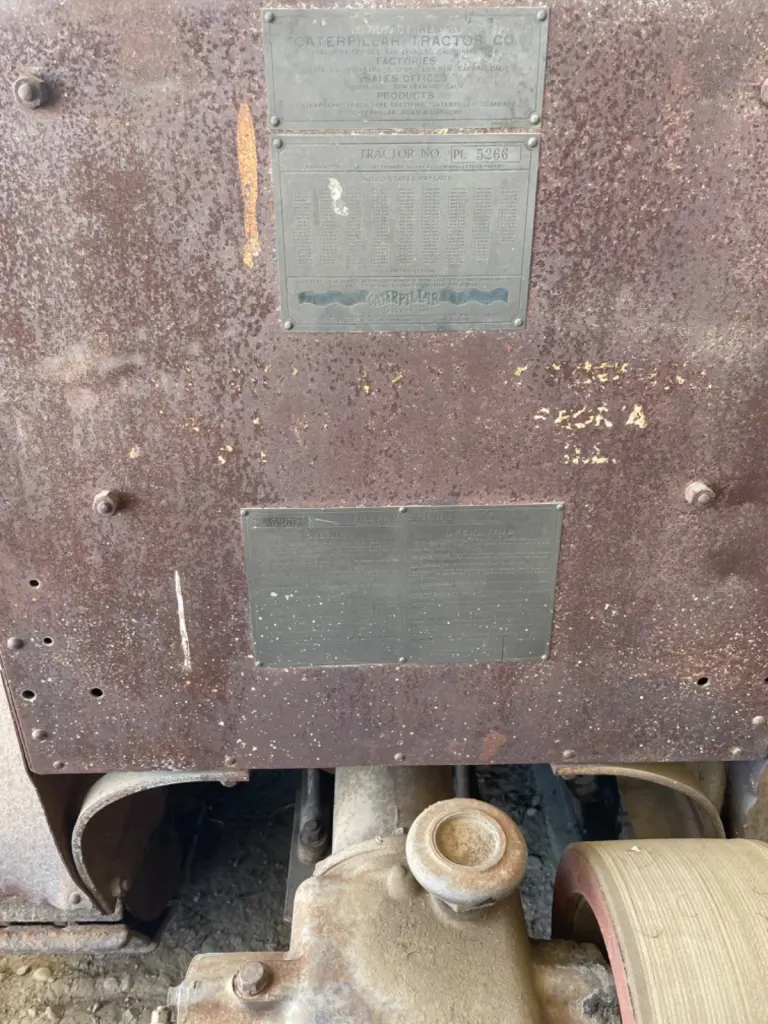

 [attachment=67274]4753B0B6-D4E1-470D-BBD5-02E0AB7D0D76.jpeg[/attachment] [attachment=67274]4753B0B6-D4E1-470D-BBD5-02E0AB7D0D76.jpeg[/attachment]Joey The Instruction plates to go on the back of the seat if that’s what we’re talking about use a small brass nail bent over that’s what all mine have from the factory Skinner

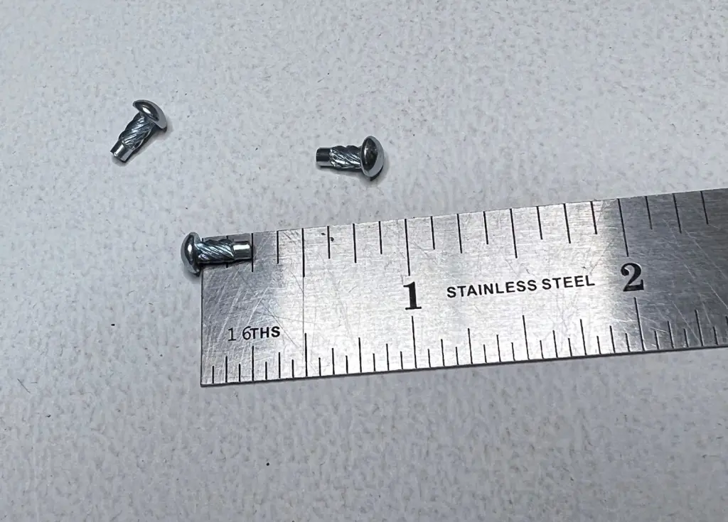

If these are what you are asking about, I bought some drive screws from the ACMOC a while back. 10 cents a piece. I see that they are listed in the store under Restoration parts but no picture. Pete
 [attachment=67283]a drive screws for data plates.jpg[/attachment]
Wed, Apr 6, 2022 1:10 AM
