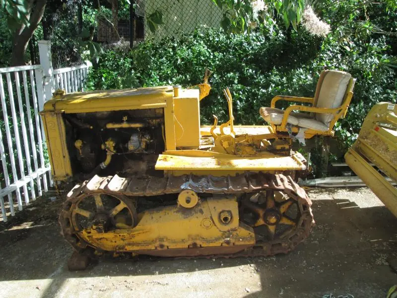

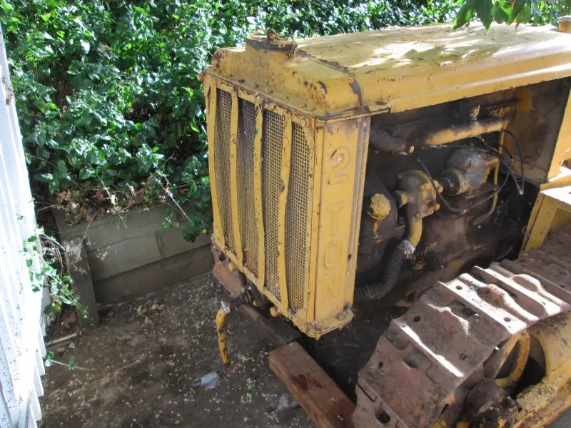

The attached photos are of my cat when I brought her home. It was salvaged from a family farm in Kelseyville, California. I found it at the local wrecking yard and paid it's scrap iron value. This was clearly some young man's pride and joy and the scrap yard was a sad place to find it. I'm starting with the engine and drive train before seriously getting into cosmetic work. The magneto (a Fairbanks Morse RV4) sparks. I found a rebuild kit for the carburetor and reconditioned the fuel tank. As noted in my original post, I am looking for an original magneto, air cleaner, and oil gauge. I've rebuilt the firewall which was cut in several places for various modifications during its working life. I'm one third of the way through sandblasting and putting on high temp primer. Most of the farm work here in rural northern California was still being done with horses in 1928. Sounds familiar with Mikes story. I haven't decided to paint it the old caterpillar yellow it wore during much of its working life or go back to gray if that was the original color. I plan to put it back to work once it's restored.
Steve
Steve

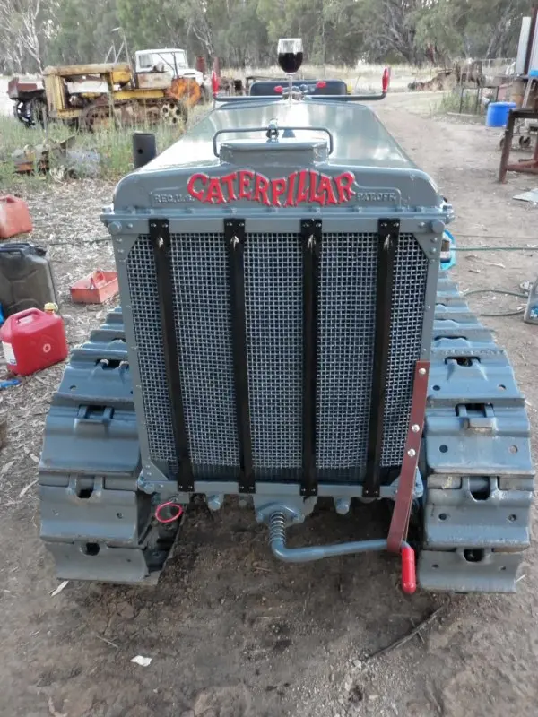

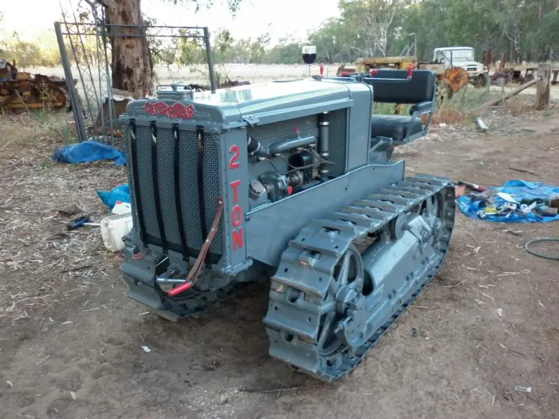

Thanks for the photo's Steve, that is a interesting 2 Ton for sure, I'll try and get a photo for you in the Salinas Valley of that 2 Ton with steering levers like yours. My advice Steve for what it's worth, is get rid of that fuel tank and get a good original one on there, I've had a couple made here in Oz, they run at about $250, it is critical you have a original one to copy if you can't buy a good used because the dimension from front to back on those tanks must not be too deep or they will not fit between the engine and Dailey aircleaner, AND, those front and back panels of the tank must be domed to absorb the engine vibration or the seams will split and leak gas. When I said I had a couple of tanks made, I think it is actually 5 or 6 tanks made, to get just one, no wonder I'm almost bald now!!

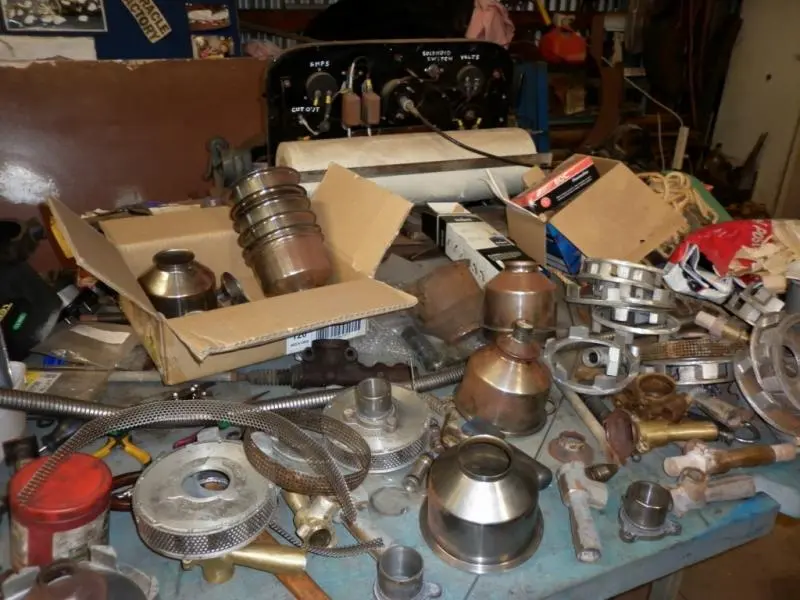

Another thing, get a Dailey aircleaner for your tractor too, it had it originally, they are filled with horse hair which is soaked with oil, your tractor will have both a Stromberg AND Dailey aircleaner, only the very early Holt 2 Tons had just the Stromberg aircleaner, put a advert in the For Sale section, someone will have the Dailey aircleaner, you need the stand it mounts to also, plus the various air pipes, they should be easy to find Stateside, if you can't find a good Stromberg aircleaner in the US let me know and I'll throw one in my bag if we can agree on a price, my Shrink still hasn't got my head completely right from making those darn things 7 or 8 years ago, in fact the old guy who helped me went nuts too, true story, anyway I'll be in Cali early June for a wedding and can post one up.
Your tractor uses a Eisemann G4 Edition 3 magneto, put a wanted ad in the For Sale section, or keep your eyes on Fleabay, they come up pretty regularly, it must have the impulse on it, the earlier 2 Tons had a manual advance retard of the spark for safe starting, yours has the automatic impulse aid, get the cloth covered spark wire too, it's 7mm, I used black and got it Stateside from Brillmans, I use Autolite spark plugs, either #3077 or #3076, $2.99 each at Napa or Sparkplugs.com. Use straight 30W engine oil in all compartments, some folks use lighter hydraulic oil in the tranny for easier turning, the 2 Tons are heavy to steer till the oil warms up unless you are pulling something, then they turn nice, I use my 2 Tons for work and play, they are a really nice little tractor and pull like a train.
My opinion is paint it grey too, those early Gas Cats have a unique history.

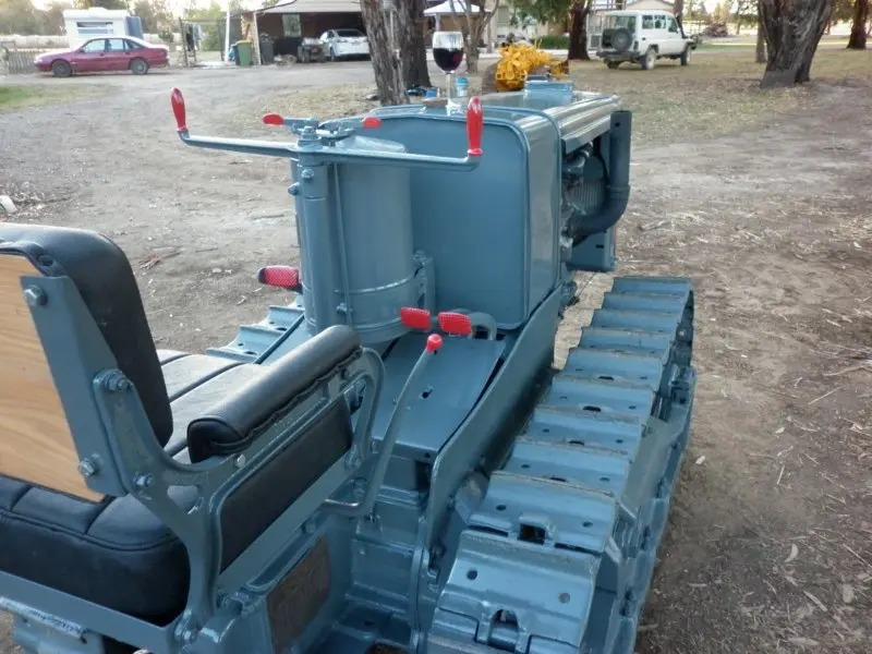

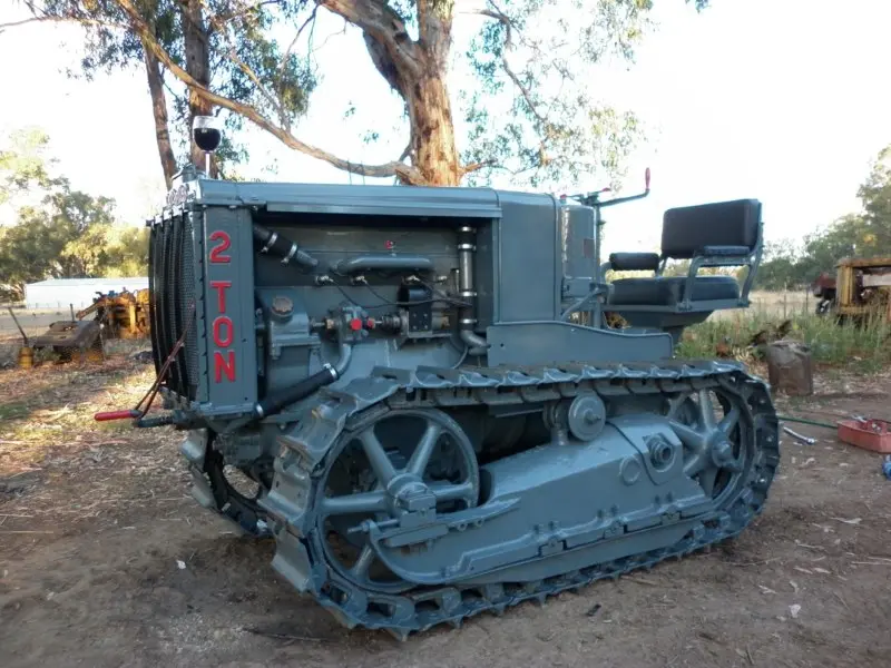

Mike,
You have done a beautiful job on your 2 Ton restoration! I have never seen one done any better!
JanM

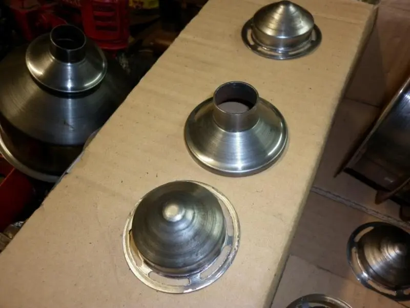

[QUOTE=janmeermans;223327]Mike,
JanM[/QUOTE

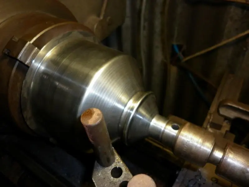

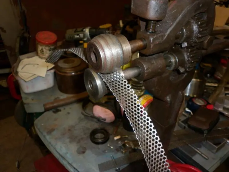

It is very lovely. Also thanks for showing the metal spinning, I would like to try that one day.
