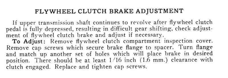

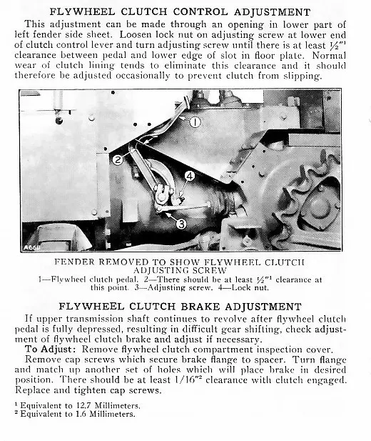

Hi Peter,
from my General Instruction Book for Early Products is the following on the 22 Master Clutch adjustments.
Hi Toby,
the 10 and 22 tractor Master Clutch and brake set up is very similar and your 10 M/C Tutorial should get Peter there.
