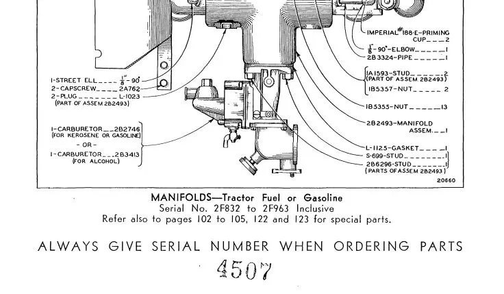

I recently acquired a Twenty Two, serial # 2F3657.
From what I've learned, if I'm not mistaken, this tractor would have an Ensign carb rather than a Zenith.
If that is correct, can someone here tell me which model Ensign carb would be correct?
And if it should be the Zenith, then which model as well?

 parts book show change to zeith k5 at 2f964
[attachment=73717]Capture.JPG[/attachment]

One of the books shows a "K5A" Zenith. I have two very early 22s and they have both been changed over to the Zenith. Probably from parts shortages. Good Luck. Grant.
