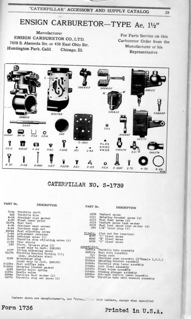

Hi Eric,
as far as I recall the Bosses Thirty adjusted as per any other carb with the high and low speed circuits seeming to be independant.
Can only think there maybe an air/fuel leak internal.
If either/both the carby body and float chamber body faces are warped or similar then you could possibly get crossover between the circuits across the gasket faces---note all the passages running next to each other in the scan below.
Also be aware that the idle screw is an air bleed adjustment and therefore this makes it appear to work back to front---in to richen and out to lean.

Hi Eric,

thank you edb, that is something i did not realize. i am gonna take the carb back apart and check that. with that white metal float bowl, warp is a possibility. have a good afternoon, eric
