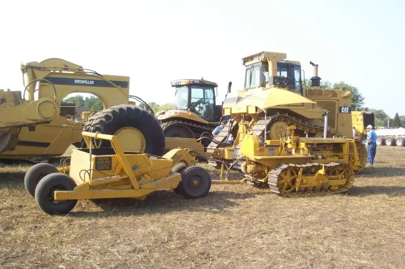

Neil, there are several different makes of two to four yard scrapers the a D2 will handle. Ashland, Beckley(spelling?) and the LaPlant Choate that I have . I have found several in recent years on Craigs List, just have to keep looking. If someone gave me $10000 I would sell my La plant Choate. The Ashlands and Beckleys usually go from $3000 to $6000. Took me 5 years to find my LaPlant Choate and another year to restore it. the second picture I think is a Beckley

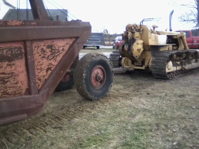

forgot to add pic

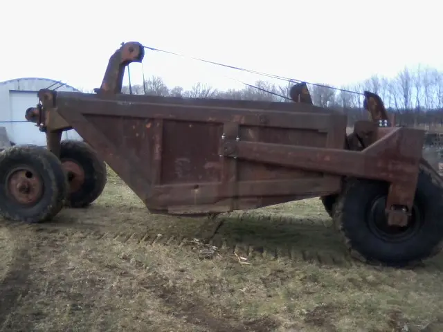

This is an 8 yard struck 12 yard heaped Bucyrus Erie S90 behind my D6 9U and it is all the machine wants by itself to get a 2/3 to 3/4 load (estimated) with a decent cutting edge, not perfect and not shined up yet either. I can push load it pretty good with the D4 but not a 12 yard load (again my estimate) and once loaded it will haul in 3rd and dump/spread in 2nd but a slightly smaller unit would probably be a better fit.
I don't know as much about the 60 but that should give you something to go by at least, I would opt for a smaller scraper as they are easier to load and more fun to operate without being so hard on the tractor. I had to do a head gasket job on mine once I started running it, scraper gives it a real workout.
