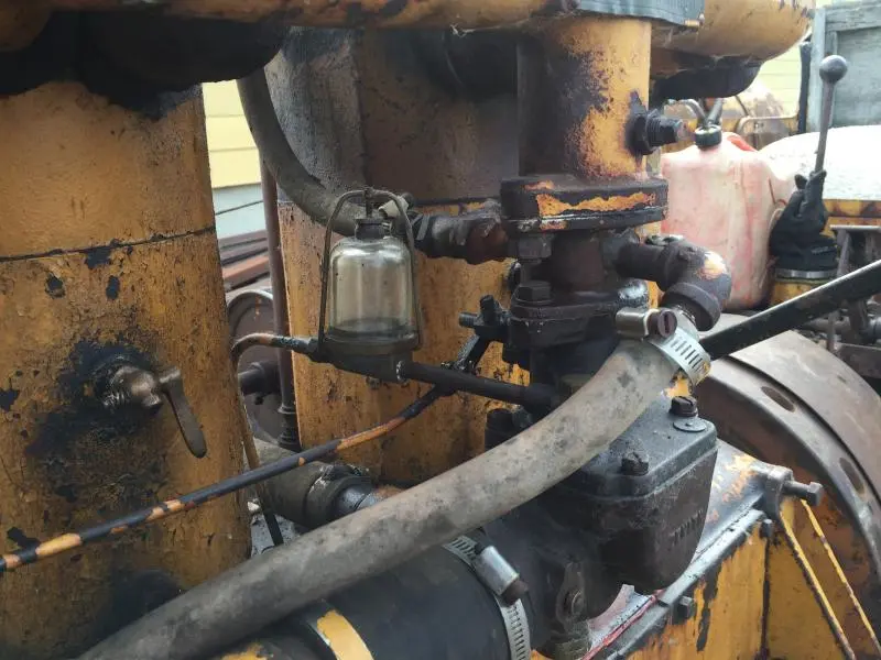

well Chad Toby got the most on the info right. Clyde is one of them guys that will away just get a little more out. the more i look at the old sixty i think i going to try and right a story for the magazine about it and how much of a hot rod it is. he dose lost of work on the big gas tractor. the maniacal fuel pumps help out a lot and he built a heater so as to not have the carb freezes up. [attachment=36494]IMG_0663.jpg[/attachment]

I see. I look forward to the article. That big ole zenith carb probably helps too. That carb would atomize way better than the original ensign. Thanks again for sharing!!
