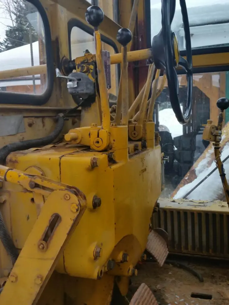

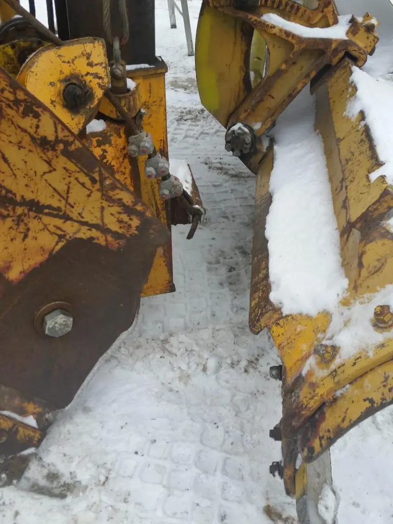

Looking for some help! I live in North Western Ontario and have this great old machine to keep my one mile road in good shape. I was going to Wing the snowbank today but there is design problem with the wing support being to close the the blade. When you angle the blade to the right it comes around and hits/stops against the wing support post. I did exactly as I wasn't supposed to, brought the blade around and it hit the post and sheared some thing somewhere? blade on left side
will not lift and circle will not turn. Right side of blade lifts and carriage swings left or right. After a bit of research it appears the trouble will be in the power control box. Is there a key or shear pin for left and right sides? The main one has to be okay as right side works. Could be the pressure relief valve? will know
more tomorrow. Anybody have any experience with this, Many Thanks, Tom

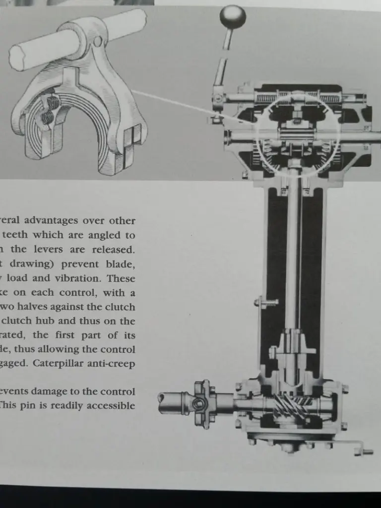

I was not aware the 12F still had the knuckle buster type pcu. The schematic doesn't really match up with the picture of the actual control.
If ..........IF .....the 12F has an improved version of the dog clutch pcu as shown in the diagram. The power is transmitted up the vertical shaft to the primary horizontal shaft that will be the side shift I think. From there power is transmitted to the functions on the outer shafts by gears meshing with the gears on the primary shaft. There should be no keys to shear etc as each set of gears (one in the front and one in the rear) rotates on the respective horizontal shaft with bushings. First shaft on the left beside the side shift (primary) horizontal shaft would be the circle reverse so it makes sense that running it into the wing support post would cause damage in the correct spot(s) ??????
One question I have is will the inoperable functions work in the opposite direction or are they completely dead? Seems like you would have had to break both front and rear gears on a shaft to disable the function in both directions .......both up and down on the left end blade control for example.
The mention of a pressure relief makes me question whether this control is all hydraulic and the schematic is not applicable.

Hi, Tommyrbk.
Sorry, I can't help as that is one model too late for me. I have been into several control boxes on earlier models but never into a 12F or the 14E which has the same type of control set-up.
Ccjersey's answers do make sense though. If it was the shear pin at the bottom of the vertical shaft, you would have no response in the controls at all.

What series 12 F?
12F's can be either hydraulic Disc-Type Clutch Power Control with mechanical relief valve limits or
Hydraulic Jaw-Type Clutch Power Control with mechanical relief valves on the circle controls and solenoid operated relief valves on the blade lift functions. The electrical circuits are fuse protected. To reset the lift function you need to hold the reset switch depressed and push the lift control lever to move the lift arm away from the stop.
Come back with the system you have.
