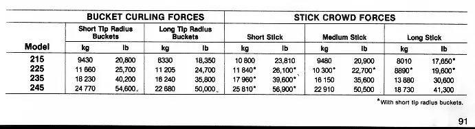

Hi Team,
this should get you there.
Tue, Aug 24, 2010 11:07 AM

It's all in what you ask for......

Thanks Guys,
The replies are helpful.-glen
