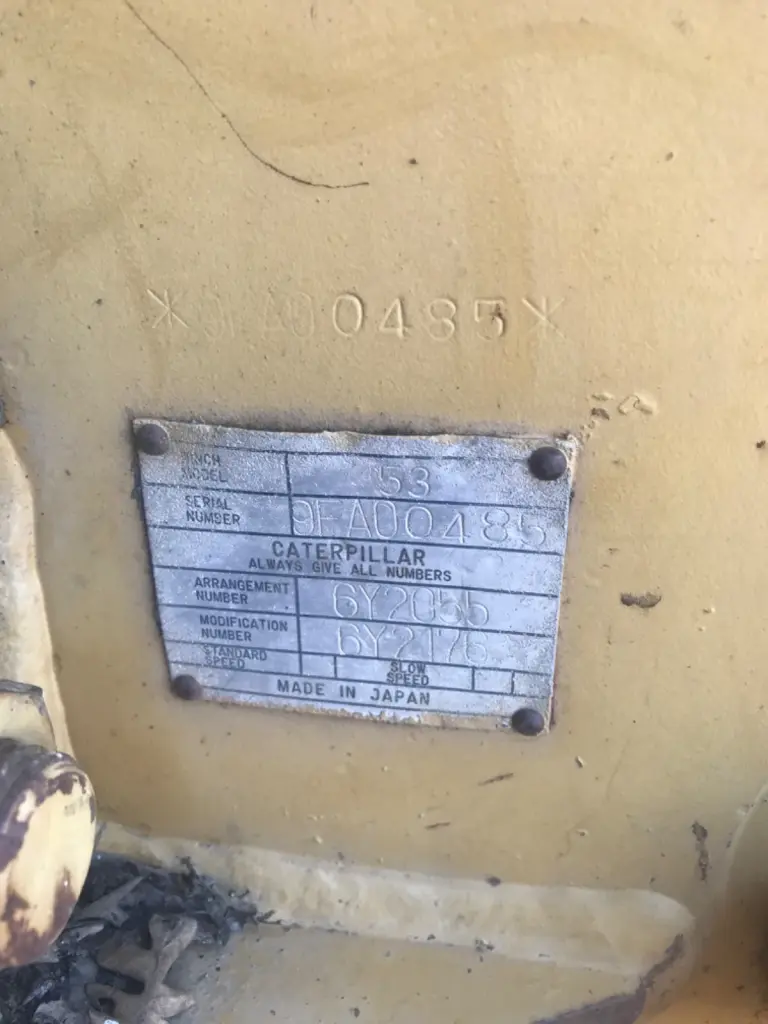

Are you sure that's a model 53 winch? The model 53 is meant for D3 tractors. The D5 should have a model 55 winch.
Fri, Aug 16, 2024 11:40 PM
Breadler
Posts: 42
I am unsure of the differences, other than I am guessing the 55 is slightly larger. The data tag says it’s a 53.

Breadler
Posts: 42
 [attachment=77380]2FE69E1C-B237-4089-91A7-167FB0712C9D.jpeg[/attachment]

I see on eBay a manual for 54 55 57 winches. The sales listing is titled " caterpillar 54 55 57 winch service specs. The title of the manual is" Specifications testing service operations and testing and adjusting". If these winches Are similar to model 53 winches, it may have some very useful information. Old magnet or other folks make know if these winches are similar enough to make it worthwhile to purchase one of these manuals.

Maybe that's why it doesn't work - if it's not the right winch for the tractor?

There is considerable difference between the 53 and 55 winch. The 53 depends on provision in the tractor drive train to uncouple the winch drive. The 54-up series have internal hydraulic clutches to uncouple the drive.
