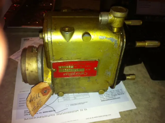

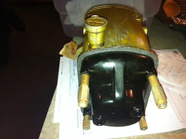

[attachment=15653]photo.JPG[/attachment][attachment=15654]photo-1.JPG[/attachment]good evening everybody, i have american bosch mag made for cat,the serial number is 3a526066 and the MJK number is 4/2360d420. I was wanting to know if anybody knew what this fit, thank you.

John from Fresno
Posts: 286
Picture would be nice...
D6 8U or 9U
John
Thu, Dec 13, 2012 8:56 AM

Ill try to figure that out real fast for you!
Thu, Dec 13, 2012 8:58 AM
Posts: 16,696
Reply to dj:
Having a rough time tracking that one down.
Did find a "C" model version in leu of the "D" model which would be the same, just later version. Has Cat equivalent numbers of
9F5113, 7F6533 and 9H4483.
Suspect it is not a vehicle application and may be military with that conduit fitting on the top.
I'll keep looking.
Josh,
Can you look up a 9H4483 part number. Looks to be that Cat number on the paper tag.
Thu, Dec 13, 2012 10:58 AM
I'll keep looking.
Josh,
Flange mount with impulse coupling - D318 engine in #12 Grader, U Series D-6 DW-10 scraper or possibly U series D-4.
Maybe for military equipment or a generator set.
Thu, Dec 13, 2012 11:28 AM

Was not able to complete the application but can verify that the Cat equivalent number is 9H4483. Just need someone to check NPR to find the application. Might be able to get your local Cat dealer to look it up.
If I had to guess I'm thinking Industrial/Marine engine D339.
The D7-17A (tractor) with D339 is close with a 9H4480 mag but that's not neccesarily a meaningful identification.
Thu, Dec 13, 2012 11:53 PM
9H4483 AKA, 7F6533 and 9F5113, used on some mid to late run 8T graders, and the U series D6.
And, MJK-4/2-360D-420 is Cat part # 9H4483.
Fri, Dec 14, 2012 12:04 AM
Thanks Josh.
Must be a late comer as it doesn't show up in my D6 "U" parts books.
Last one I see is a 9H4479.
Fri, Dec 14, 2012 12:51 AM
[quote="fordhook"]Flange mount with impulse coupling - D318 engine in #12 Grader, U Series D-6 DW-10 scraper or possibly U series D-4.
Maybe for military equipment or a generator set.[/quote]
Definately not on the D4, they didn't use an impulse coupling.
