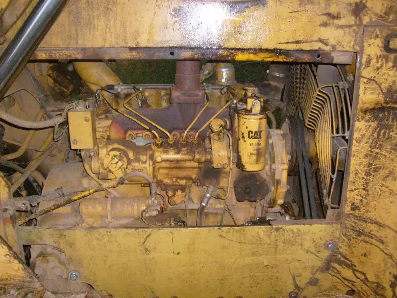

does anyone know where i can rent or borrow the plate to time the injector pump on my cat 941 with d330c engine?

d9gdon
Posts: 888
I think I have one, let me look. I know it is printed on it not for use on one of the 951 engines, but I don't remember which one.

this is the only picture i have of it at the moment, does this tell you what type it is. thanks.

Mine is 8S5417 and printed on it states "Do not use on 951B engines shipped with 4.5" bore"

some cat Dealers may rent out tooling with a deposit left for surety.
Ours did, so a phone call may get you some success with the correct tooling.

The 8S5417 plate is the thing you need for this 4-3/4" bore engine, it has stamped on it not to use on the 4-1/2" bore engine
