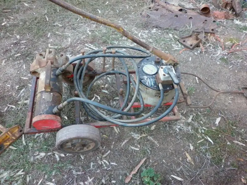

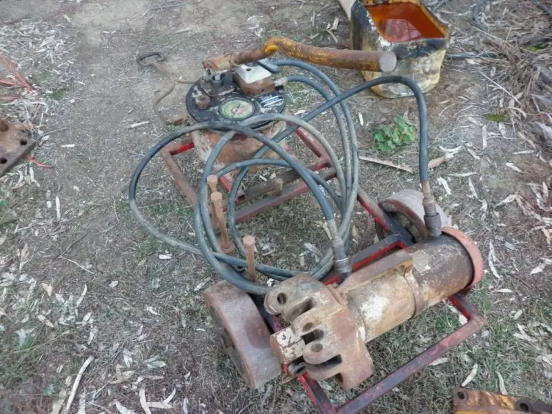

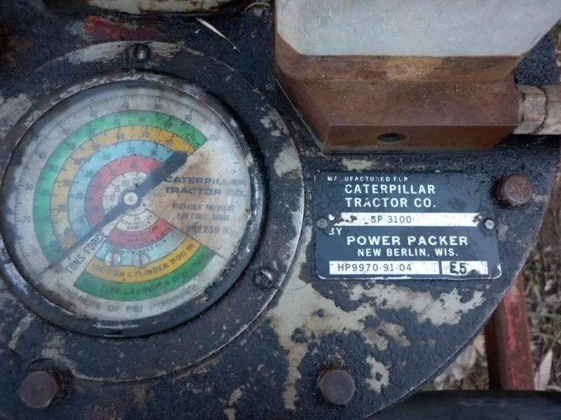

Last year I bought a used Cat hydraulic push puller and ram built by Power Packer, the Cat part number of the hand pump is 5P-3100, the Power Packer number for the pump is HP9970-91-04, I think it might need a new seal kit put in it because I can't get it to pump past about 35 tons but I can't find any reference to that unit on Google, does anyone have the Cat part number for the kit or even a parts diagram for servicing it, I will need to contact the Cat Dealer here in Australia and the info I have the better, and can you please tell me if that unit is 100 tons or the 60 ton model?

The rebuild kit should available through Caterpillar, they are easy to rebuild. That pump should be a 10,000 psi model and used on all the Cat and other brand rams that are rated for 10,000 psi, from the 15 ton to the 100 ton units and others.

Thankyou everyone for your expert advice, our Aussie Expert Eddie Bedwell has suggested it might just need the pressure relief valve turning up and I hope it is that simple but the first time I tried it no matter how fast I pumped I could only get the pressure up to around 35 tons and it would slip back to about 25 tons and hold it overnight, the next day I got it up to around 40 tons and it would hold about 30 but it would not go any further and I suspect it is pulling air in past the piston.
My local Cat Parts guy is a real nice fella but he has never seen a D2 or D4 so I was hoping to get the Cat part number of the seal kit.

Probably needs a good cleaning.....junk in the pressure relief valve seat.

I hope it is that simple Pete, I doubt it had been used for 20 years before I bought it and with Eddies help last year we gave it a internal clean and oil change, from memory it was pretty clean internally but I've just printed off your parts scan for reference though I notice that sheet doesn't show the location or part numbers for the seals.

Mike the ton rating has nothing to do with the pump, if you are making psi the ram will give you tons so the bigger the ram the more tons. I had a lot of trouble with those pump units at the dealer over ther border. The old type units gave no trouble, the round ones would work fine at home but when you got to the job they would play up. One of those pumps made me work out how to change sprocket rings without taking them off the tractor. I drove 2 hours on dirt roads to get to a D6 that the customer had stripped down for me to pull the sprockets and when I was set up and tried to pull the pump would only go about half the psi needed to remove them. After looking into the pump with unhappy customer there desided to cut and weld on the tractor.

I'd be suspect of that ball check valve between the low pressure piston chamber and the high pressure discharge. The part that doesn't have a part number ???. Could be either ball check not holding, the lowest one would be more likely to catch crud or corrode.
