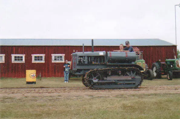

We have been quite happy with mixing equal parts of white and black paint for the gray. We usually use nason but I am sure others would give the same results. I will see if my boys can post a picture of a Sixty and Thirty that have this paint. I think you would be quite satisfied. Gene
Here is the mixture of half black, half white that Old Cats as talking about. Jeremy
Jeremy,
Is that your Thirty? Just like mine with the cold weather tin except my air cleaner is mounted forward right at the radiator. Good looking Thirty.
