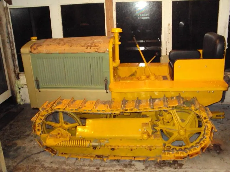

[attachment=11064]kleiner zoom(2).jpg[/attachment] hi here is a picture of the perkins 3 cilinder diesel in the 15

[attachment=11065]07 DSC00508 (3).jpg[/attachment][attachment=11066]07 DSC00508 (4).jpg[/attachment][attachment=11067]07 DSC00508 (2).jpg[/attachment] and 3 pictures more, now with the hood and sides you can not see the engine so good that its not original, i also mounted the exhaust to the other side wich is original
Hello MARCOTEN-
With the 15 oil pan gone what does the track spring bear on?

an u beam iron, they made a new frame for the new engine you can see it on the first picture
, i would go for an engine overhaul in your case as you can keep the tractor original, i did that on my ten aswell, 2 new cilinderlinings, new piston rings and the engine is like new! i bought the perkins conversion like this i did not convert it myself, as i would rebuild an engine offcourse.
