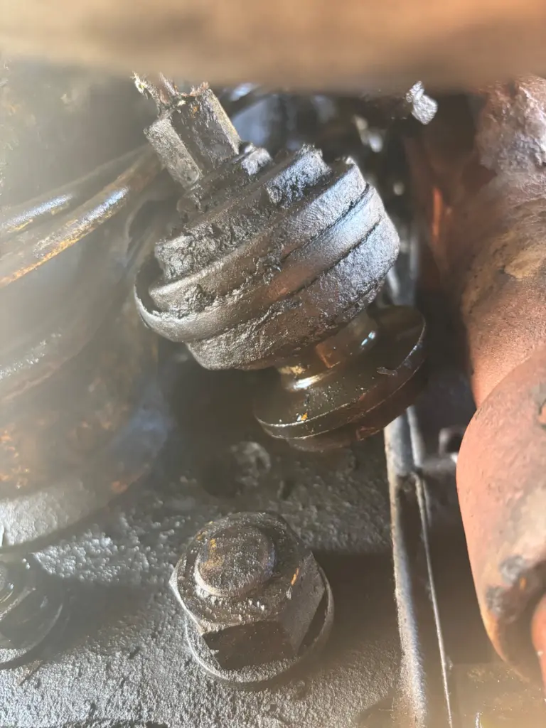

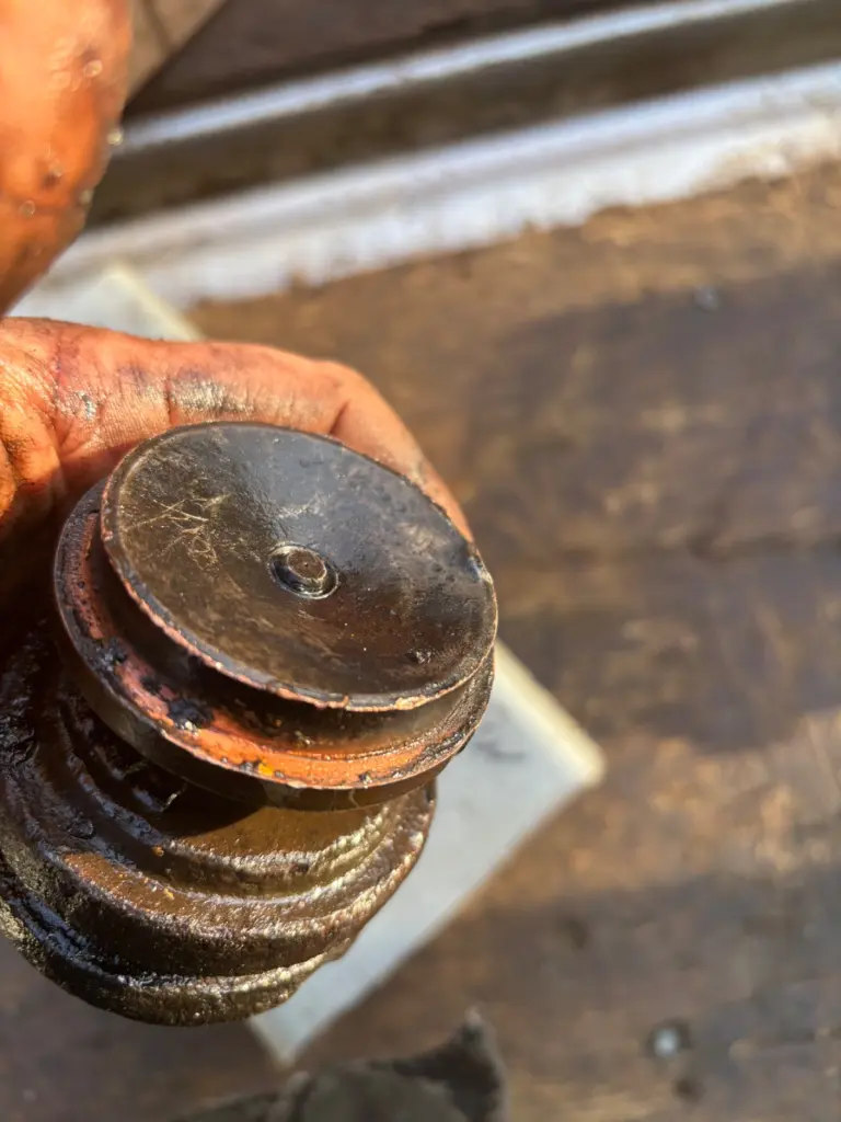

Started our D8H up today and the pre-cup blew out. From the look of the pictures, the bottom half is still in the machine? What I have doesn’t look broken, but there’s got to be threads to hold it in place correct? No glow plugs on this cat.

Not all that uncommon to have a chamber separate at the furnace brazed joint. Usual repair involves welding a nut or bolt to the remaining section in order to unscrew the lower half.

Thanks OM. After I get the other half out, could a good welding/machine shop repair the precup, or am I going to have to find another one?
Thanks again.
Sun, Mar 2, 2025 2:39 AM
Posts: 16,759
Thank you received: 41
Reply to mlauck1:
Thanks again.
Get a new one...part # 9M8025 = 2P0483 = 7S5784

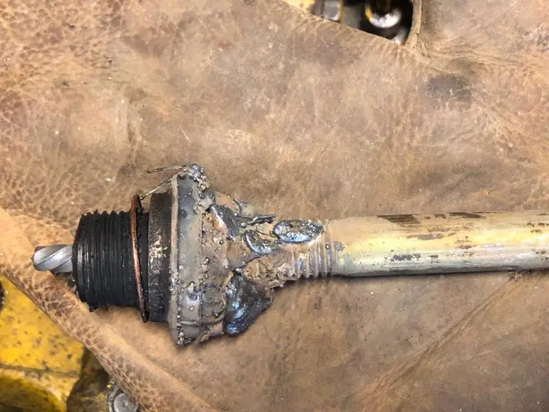

OM did you wait some time before attempting to remove after welding? I was thinking heat expansion from weld then wait to cool/contract may help to remove thread end easier.

Yes, let it cool before removal.

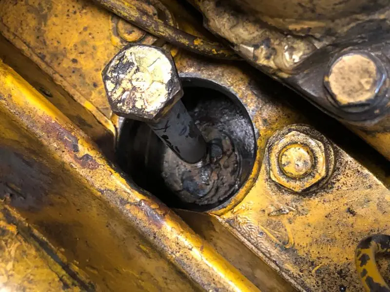

I got a good weld on a bolt, it’s TIGHT. It would be left hand thread would it?
Fri, Mar 7, 2025 1:17 AM
mlauck1
Send a private message to mlauck1
Posts: 12
Reply to mlauck1:
Got it! Thought I welded the bolt to the block.
Fri, Mar 7, 2025 1:26 AM
