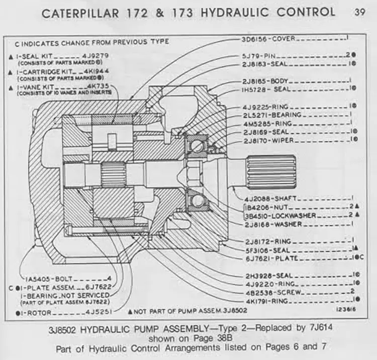

Your part numbers do not seem to apply.
This is the pump you should have according to your tractor s/n
If you managed to break a shaft the drive gear/spline is most likely severely worn and should be replaced also.
Do a Cat number parts search on www.machinerytrader.com for pump parts. Complete pumps and shafts seem readily available but in the US.

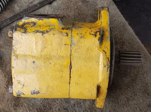

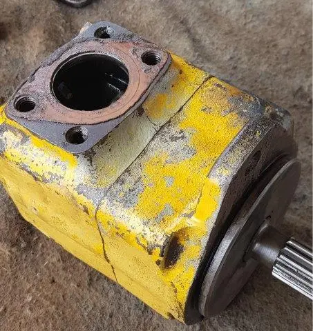

I have removed the pump and taken pictures, try to figure out how to load them. (already small file size)
Furthermore, did I track on my partlist the part number and pump. I believe that my book reflect the pump that have the tilt, as mine do not.
On my part number for the shaft is 4J6353. Will it be the same as for the pump on the pic.
Thank you for your help.

Thanks OM, I think it reflects to the pic taken.
Now , I can starting looking for parts.
Any advise on the repair.
Thanks for your valuable feedback.
4J6353 is the shaft for the two section dozer and tilt pump. Not the same as dozer/ripper I show. Replacement is straight forward but as I noted the drive gear/splines are probably severely worn as well and if that is the case it should be replaced or the old spines will eat up the new splines on the replacement.
Your local Cat dealer may have the parts, have you checked?
I was hoping for a picture of the hydraulic tank in order to identify your system.
