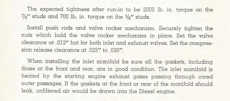

[attachment=30876]valves.jpg[/attachment]
Hello , here is a part of the page out of the shop manual for the 3T D7 .
Have a nice day , johan7
