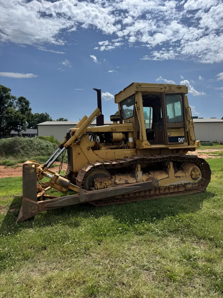

Recently purchased this machine after about 8 hrs of use transmission oil started coming out of starter/solenoid. Ran perfectly fine and was just checking fluids at the end of day when it happened.
Drained almost 2 gallons from housing. No debris in the screen or any filters.
Planning on checking inlet and and outlet pressures of converter and I’m gonna make a hose to attach to scavenger pump outlet and clock the rate of return of the scavenger pump.
Unfortunately I believe this is a on going issue with this machine because previous owner states he replaced scavenger pump and converter in the past few years.
Any advice or experience would be greatly appreciated. Thanks in advance
